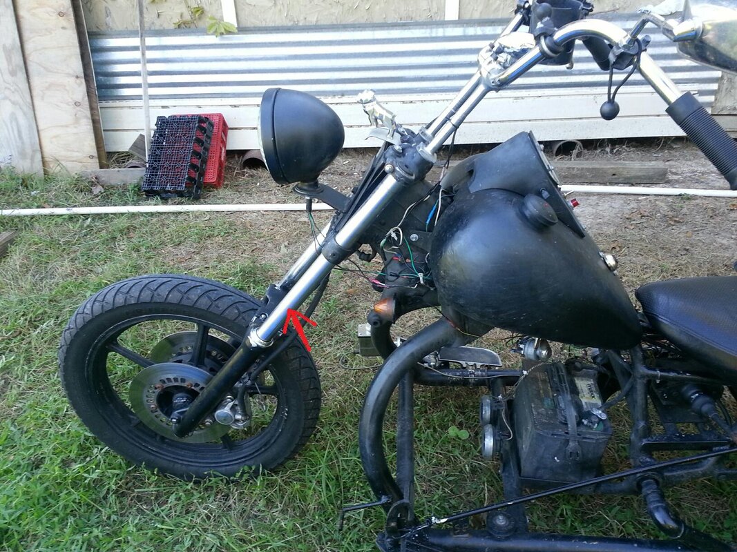

I recently bought a used homemade VW Trike. It is titled as an '84 Virag, and that is based on the vin on the neck. The title does not say what size the Virago was and I don't think the previous owner is honest enough to bother asking. It looks a bit lighter than I would like. I asked a local reputable independent shop about changing to heavier forks and was told that it would have to be measured and then miced for bearing size ect. It's my only transportation and I'm on a disability budget. The shop time and cost to do it doesn't fit. Is there a simpler way to determine what other front forks (triple tree ect.) could be swapped out? Something in the weight class of a Nomad or Venture .

Apparently they were made with engine of sizes 500cc, 750cc, 1000cc, 1100cc. Measure the diameter of the tubes and you can find on the internet which front end you have. My trike has a front end from an 850cc Suzuki and it has held up fine. I think it would also depend on how much weight is on the front end. Most VW trikes tend to have more weight transferred to the rear because the running gear is in the back. Post some pictures so we can see what you got.ThumbUp
Well I'm tired of trying. I've tried to get a picture of the front of my trike added here, but I'm technologically stupid and can't seem to pull it off. But it's homemade from about 2 1/2 pipe that I figure is probably sch 40. Front of the front tire to back of the rear tire is 11.5ft. I figure it is a fairly heavy trike .

I think you have to have so many post before you can post pics. If you want to email it to me and I can post it, let me know and I will PM you my email address.

Just find someone with a good dial indicator and have them measure the tubes. Most NAPA stores should have one and will do it for free. Mine is a 33 mm so I think your safe with what you have. Just make sure the neck is mounted safely and strong.
My front legs are 37.9. Harbor Freight mic. For my mechanical abilities, it's close enough. So I figure it is enough front end for a while. Thanks for the info folks.
