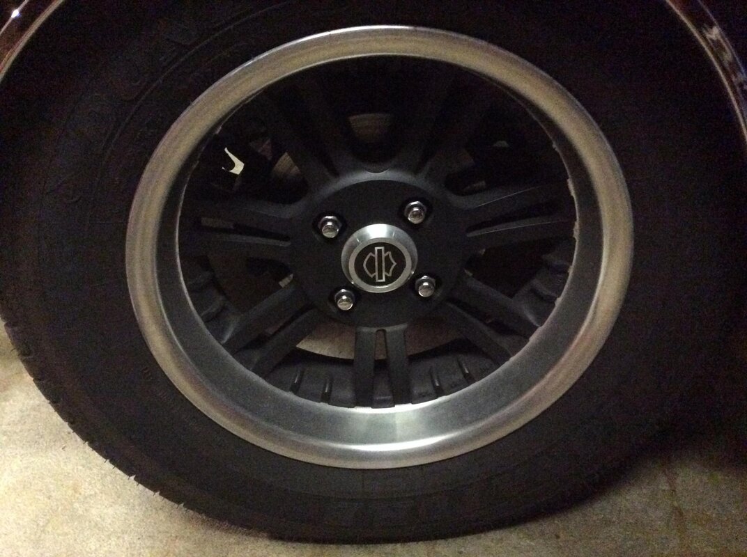

I rub them down smooth with a scotch bright pad , then just reclear coat them. Did the same on the wheels, front and back with black rustoleum rattle can. 3yrs later they still look fine. Not into the aluminum polishing rutine, bought it to ride ! :Dorag:

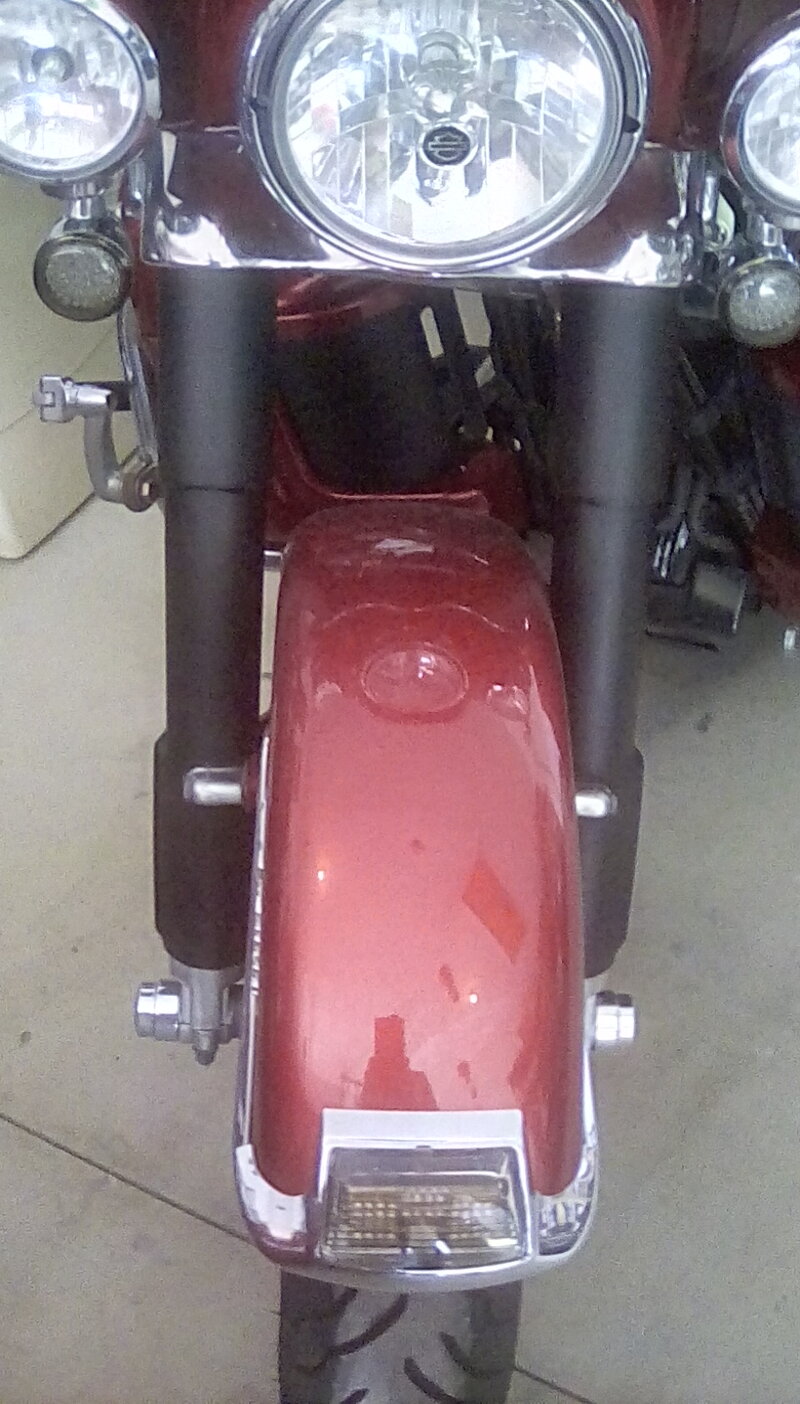

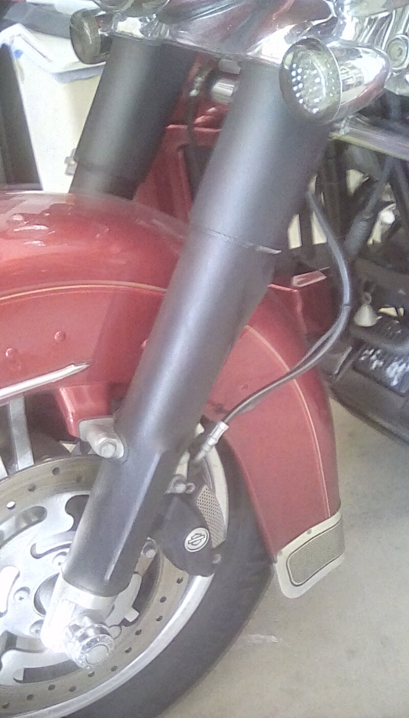

Inexpensive Solution to Pitting
My '13 TGU started pitting about the time the warranty ended. Too much exposure to salt, sand and "love bugs" in FL and road debris all over the U.S. and Canada. So rather than go the expensive replacement route, I lightly sanded; then polished; then waxed. The final coat....Chappers.
IMG_20180316_171716_hdr.jpgIMG_20180316_171656_hdr.jpg IMG_20180316_171550_hdr_kindlephoto-790807421.jpg
They're made of a material similar to the seat coverings and attached by sewn velcro strips. If you are interested, and the card isn't clear enough, it's www.chappersllc.com. Cost me about $50.
