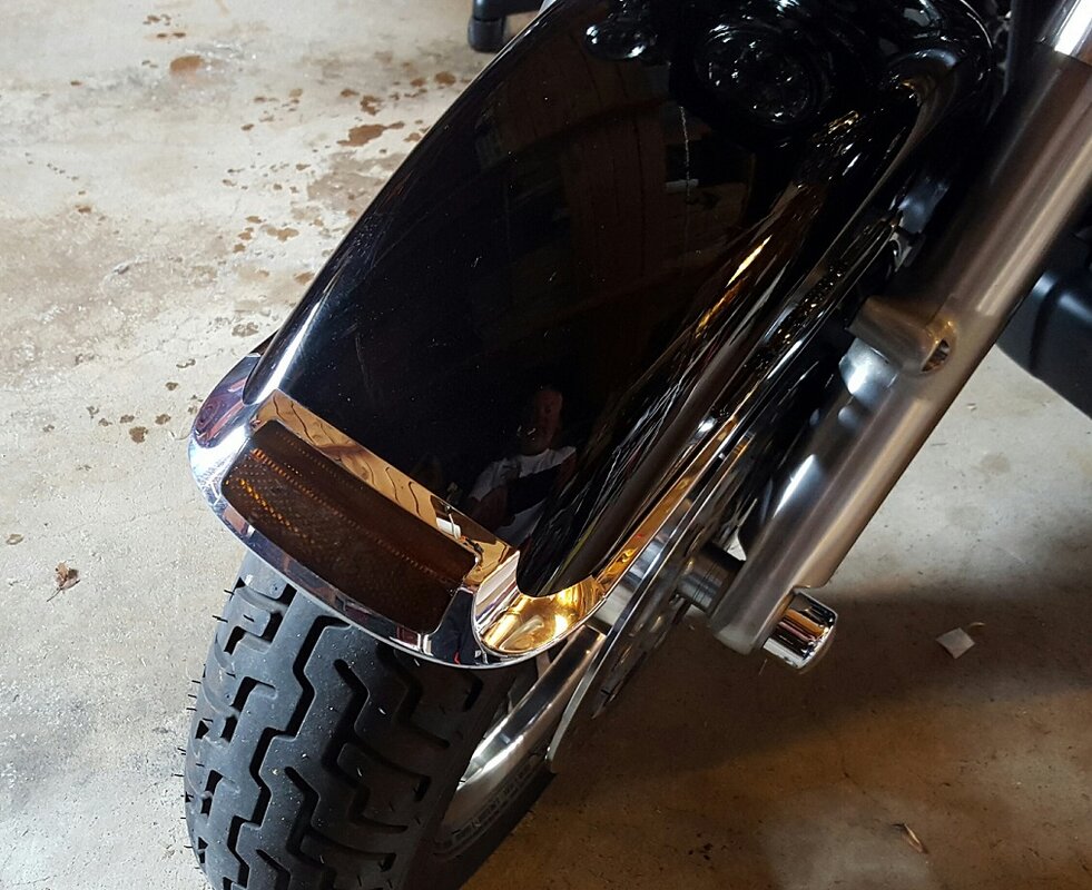

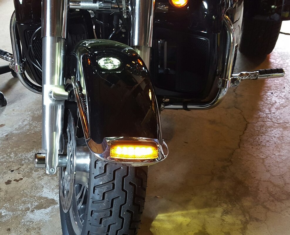

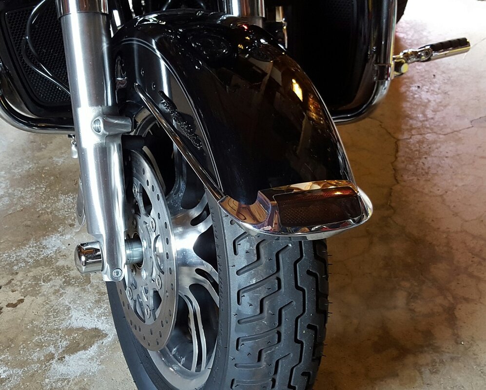

After finding out that the lens can not be replaced and the entire unit {$129} has to be purchased, I decided that was not gonna happen! Oracal 8300 vinyl Sheet. Cost me $10 for a 12"x30" sheet. The color when the bike is off is the same as the Smoked turn signal lens. And as you can see, when on it too comes thru yellow as needed by law. Yeah Baby!!

Place called Xtreme Graphics ~ But I would think any of the Billion places that make wraps and graphics for cars. Or if ya tell me my trike is the "Coolest" I can just send ya a slice!! LOL

Very COOL! How did you apply the sheet to the lens?
A warm Day Helps....But I just started in the middle and worked my way out to the edges. The vinyl stretches pretty good - The heat from your fingers helps. I've never tried it before, but only took maybe 5 minutes and have no bubbles. Then used a razor to cut the excess around the lens, carefully. And just a note:
The lens has two raised Logo's near the bottom edge. I think if I where to do this again, I might gently file those smooth. I thought about it before I installed the vinyl, but didn't want to take a chance it looked like shit and now I have a dull, albeit smooth, Front lens. Not that it looks bad, and most might not even notice...but that's just me
jc
It sounds like you applied this to the 'outside' of the lens? And if so did you remove the lens from the housing first, then put it back in after you applied the vinyl?.
Sorry for not being clear....Yes, I did apply it over the outside of the lens. I figured if you could take it apart off the bike - You could change the lens that way. I am sure the "Light" is a closed unit. I didn't worry about going over the edges of the lens - It was easy to cut, being careful, around the indent of the lens and bezel using a new blade.
