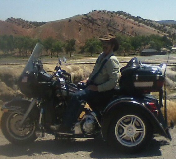

First go to the right side of the forum and click on the triple tree to see what rake is recommended.
Contact zook with any questions.ThumbUp
