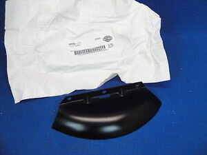

My op was asking if the fork-mounted air baffle (the "dog dish" that's popular on the touring bikes) was available on the trike models (thee dish wont fit without some type of adapter due to the steering stabilizer). My GG is a 2012.
This be the doohickey I was talking about.

Thor, I found the link for the adapter:
http://www.hdforums.com/forum/tri-g...g-adaptor-plate-for-hd-front-fork-baffle.html
He even has a printout of the dimensions. When I made mine out of aluminum I also had it powder coated (just a personal preference).
That was PRECISELY what I needed...many thanks! ThumbUpThumbUpThumbUpThumbUpThumbUpThumbUpThumbUpThumbUpThumbUpThumbUpThumbUpThumbUpThumbUp
