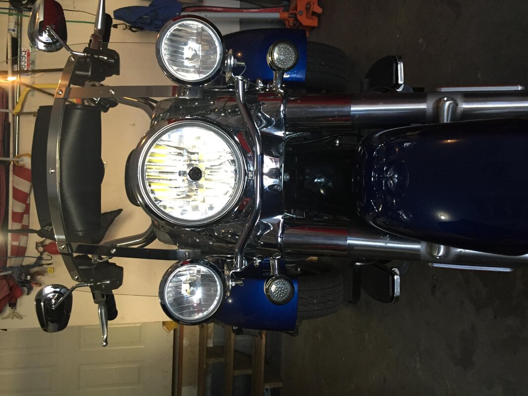

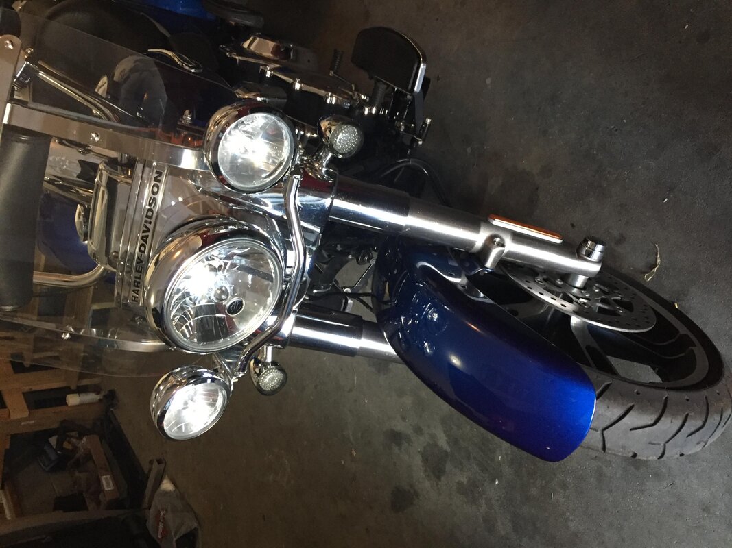

Got a deal on Amazon from Eaglelites!! Upgraded from LED bulbs to straight LEDs!!!
Hate it when a pic turns!!! Oh well, you get the idea!!!
They look great! I have been holding off going with LED heads and tails. I like that the conventional bulbs are/were commonly available.......but, as time goes on, LEDs seem to be becoming the mainstream - and the price of them is starting to fall. In time I will probably convert; but, not now.

Hrolf....look above at my last post with my LEDs from Eaglelites.....I have a 2" wider Clearview windshield, and you can see the top half of my JEG fangs!!!! If you want I can get a better pic!!
I missed the fangs, and thought that was a clearview shield! Just didn't want to ASSume LOL
