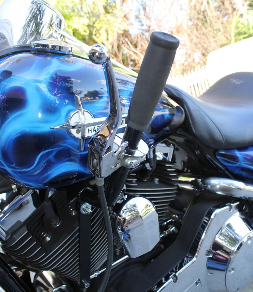

Here's a shot of a hand clutch/shifter mod that might be of interest, if your existing shifter cannot be used. (Disregard if you have a hydraulic clutch m/c)...
Nice set up
I bet a hydraulic set up could work on that HMMMMMM
