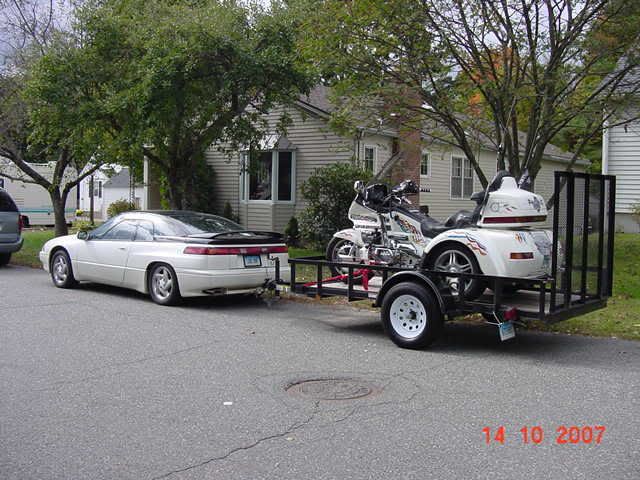

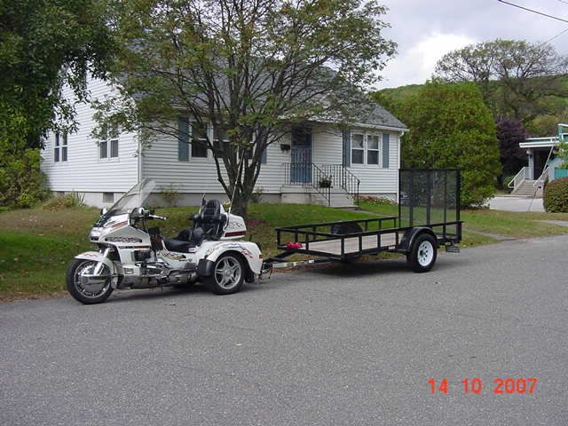

I have this. Never towed it at high way speed with trike on board. Never thought about towing my trike.....
Shop Carry-On Trailer 5-ft x 10-ft Treated Lumber Utility Trailer with Ramp Gate at Lowes.com
Yes towed it home empty with the trike 20 miles....
With military discount $900
From the specs I've read, trikes are less than 5' wide and other than the Roadsmith HT1500, slightly less than 10' long. I have a Big Tex landscape that is 6'x10' I.D. you may be able to fit it onto a 5'x10', but I would try one before buying.
I have a Goldwing trike and it fit onto a 5 x 10 nicely. Recommend getting a tilt bed and add a winch in case the trike is DOA.
