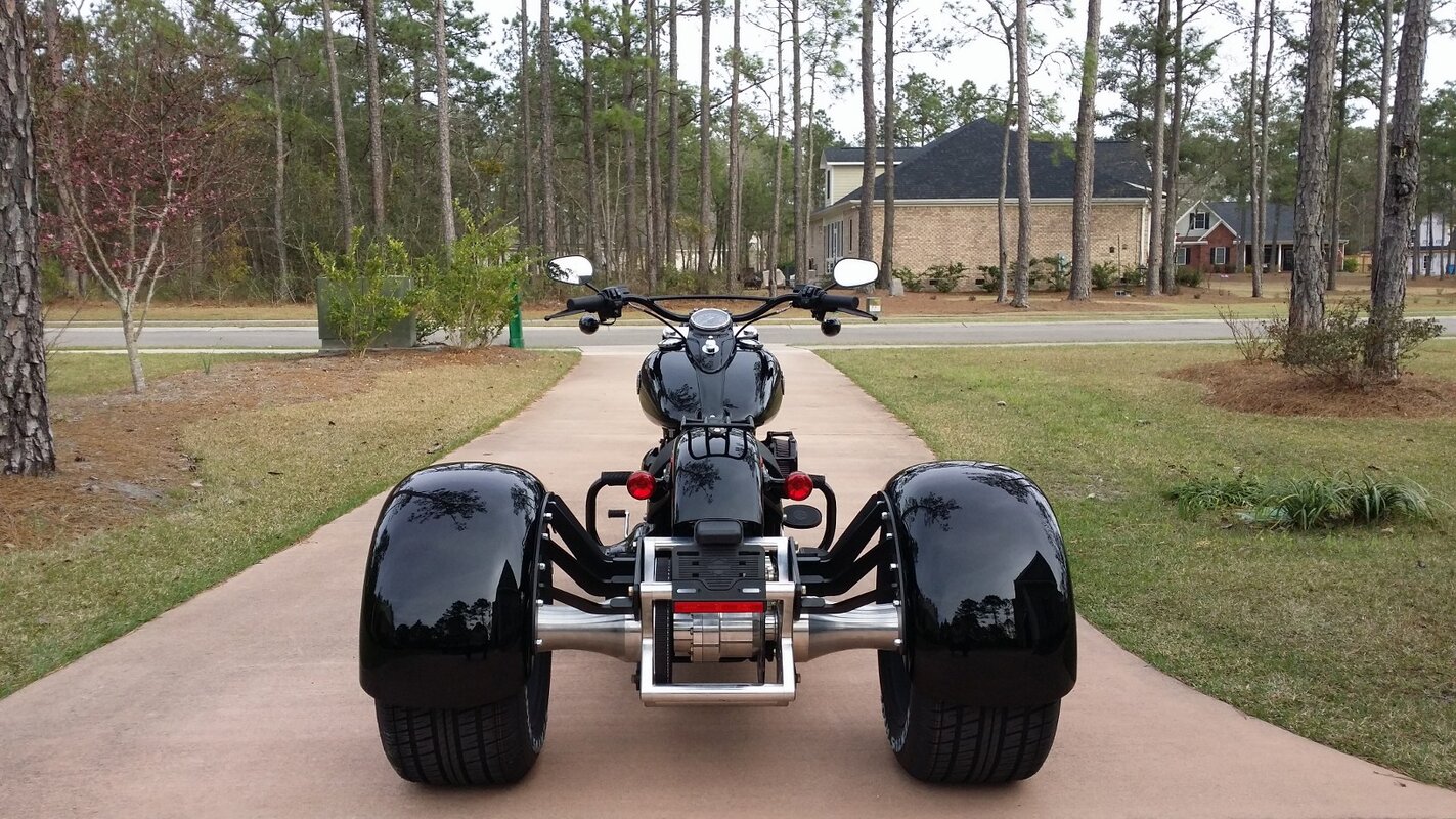

I recently converted my Slim S with a Frankenstein kit and love it. There is no need for a steering dampener. You will want the raked trees to make steering easier. It increases the rake to shorten the trail to between 3 and 4 inches. When installing the trees make sure to follow the instructions and tighten the neck more than on a 2 wheeler. Mine is stable at all speeds with no wobble. I can take off my hands at 80. I have the single rear brake and thought with the extra ground contact it would be stronger but it is similar to before the conversion. I would recommend the upgraded wider wheels they offer for a fatter look. I think they make a huge difference in the look. My wife has the standard wheels on hers. Here's a pic of mine from behind. Good luck.
Oops! I forgot the pic. Also, I have taken corners very aggressively with no indication it wanted to tip. If you don't like the fender location in my pic you can change sides and have them more on top or more to the front depending on which fender you use with which fender mount.
