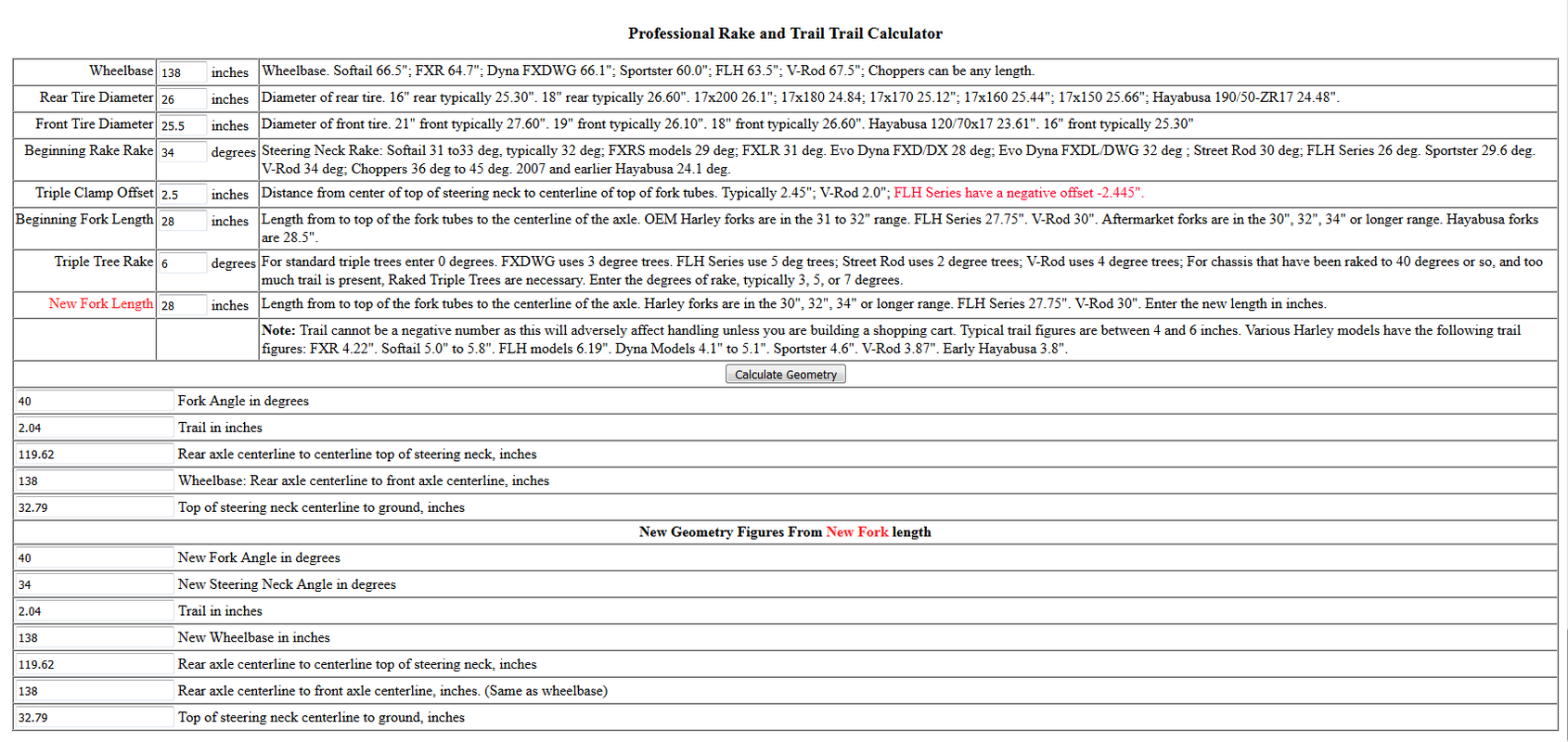

Thanks for all the responses! Links provided a ton of info as well. The rake and trail calculator got me on target quickly.
Moved the mindset quite a bit from motorcycle to car like. (I have never driven a trike)
Did not find info on the "axle-axle-axle triangle" mentioned?
7 degree triple trees get me to 2.5 degrees of trail.
Opinions on getting that all from the trees or splitting it with offset raked neck cups?
Got the rake and trail starting point using the calculator. A little less rake than with the 7 degree trees and better trail (I think).
Any opinions would be welcomed.

After looking at your chart, I offer this recommendation for your review:
Facts used - 1) 40 degree effective rake, 2) tire diameter 25.5", 3) desired neck height 32.79".
1. 1/2 tire diameter = 12.75", so axle is 12.75" from ground.
2. You then need to get 32.79" - 12.75" = 20.04" rise from the fork tubes.
3. At 40 degree angle, each inch of fork length = (90-40 degrees) divided by 90 = .555" rise.
4. So 20.04 divided by .555 = 36.1 inches of fork length needed.
5. So your forks will need to be 8" longer than the anticipated 28".
As a crosscheck, 28" fork length yielding .555" each inch = 15.55" plus tire radius of 12.75" = 28.3" top of tubes/neck height, short of the desired 32.79" by 4.43". 4.43" divided by .555 = 8.05" additional needed.
By your chart, you can see that you can't take a starting fork length of 28" and kick it out another 6 degrees and it still be 28". So your New Fork Length in the table should be 36".
You asked for a check on the numbers - so I hope you take my comments with a grain of salt. I think you are well on the way to doing a great design. Keep up the great work, and if my numbers are all wet for some reason please point it out.
I look forward to seeing this project progress.

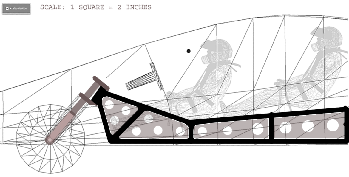

Hi Loner, I'm not much of a mathematician so here is what I came up with on graph paper. 1 square = 2"
(Just noticed graph lines not showing up in scan) I'll work on that.
My measured fork length is 29" top of trees to axle center.
Started fork at 40 degree rake.
Backed out 6 degree tree to locate neck.
As it sits it has 10" ground clearance and wheels are 26" diameter in the sketch.
I guess my drawing does not match how the rake calculator works.
Thanks for helping on this and check my drawing against the numbers if you could.

From your new numbers:
Top of tube height will be; 29 x [(90-40)/90] + (26/2) =
29 x .555 + 13 = 29"
Neck height will be; 29 - (2.5 x .555) = 27.6"
Does this compare with your graphical depiction? It deviates quite a bit from your target neck height of 32.79" in the first chart. What are you using for your objective (fixed) points - neck height, tube length, etc.? With that target fixed data established, everything else is a variable that can be calculated and adjusted.
One note from a practical side, testing that I have done in the past has shown that hydraulic tube forks generally lose their compression and begin to flex at rakes above ~37-38 degrees. You might consider using a leading link type fork for your design that will allow total flexibility in setting fork dynamics.
Again, my calculations are always to dementia at any given time.

Some of the confusion seems to be the calculator (which I have deemed more or less useless). The neck height was not an input, the calculator did that.
Maybe I'm working backwards to the norm.
First was the wheel tire location with the 29" forks attached and leaned to wherever the neck ended up. It was not a variable. Everything else was derived from that location. Thought the trees would bring in the trail to an acceptable level.

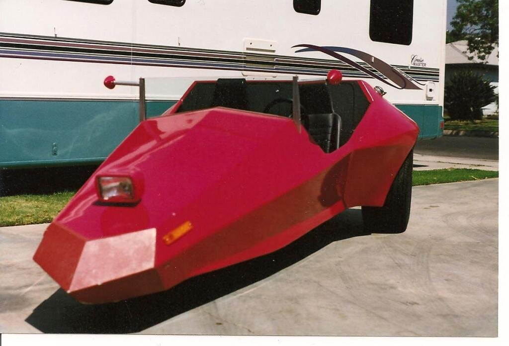

I agree that the rake/trail calculator numbers are somewhat muddying the conceptual layout. That myriad of calculations prompted a bit too much drill-down on my part. So for the sake of simplifying let me offer a bit more reserved comments and considerations.
One of the trikes I have built in the past was called a Trimuter, roughly based on a design originated by R. Q. Riley (do a search to find his website). Absolute poor quality since this photo was taken before the digital age came about, here's mine:
Google 'Trimuter' to get better photos of others built from those plans. Not easily seen in my photo, but it uses a front fork that lends itself to a flexible layout to fit a variety of designs. The fork and frame layouts can be better seen in these images:
Trimuter Frame 1.jpgTrimuter Front Forks.jpgTrimuter Frame 3.jpgTrimuter Frame 2.jpg
The leading fork link is single sided with an automobile type hub. That allows easy removal of the front wheel and flexibility in choosing wheel types and sizes.
If you are fabricating your own frame, this would be an easy addition. Check out Riley's site where he has a truckload of information as well as design concepts. I also will refer you to a similar thread here on TrikeTalk where we discussed front end configuration for a low, enclosed trike design; http://www.triketalk.com/forum/threads/28242-Shortening-forks-on-GS650 .

My TriMuter build front end is about the same as a 3-wheel golf cart, high speed sucked, but around town it was great, there's photo's here under VW Trikes and it is red...
what size is the front wheel? Maybe a larger one would help that highway ride.
