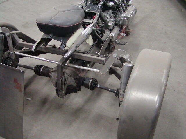

couple ideas
not a ton of money. i dont think i have spent over $1000 on any conversion... after the cost of the bike
for me independent rear is a must, personally i like bike conversion over vw, make sure you have your trail right... you will find many different numbers... i find 1.5 - 2.5 inches works well... not just an arm chair builder here... built my 1st in 79 and have done a bunch since also do sidecar installation and set up which also need a modified front end to get the trail right. did my 1st hack in 84 and lost track of how many since then
the one that that is rear engine is a Subaru engine stuffed under a rupp body

no worries always welcome to pick my brain.. get it while you can lol
even if the frank was cheap way more fun to do the whole thing.
granted not my 1st build and i am a fabricator by trade... but the v max was a quickie
came home on thur night and did a 5th gear smoke to the rim... following sat it was running on three wheels, the subframe is in the v max.. was a surprise for my ex..
i say running.. there was still a lot to do. suspension was struts and the front end was still stock... non the less she liked it... and ran the snot out of it too
what is the budget for the initial bike?
personally hd is the bottom of the barrel for me..short on power for the traveling i do especially pulling a camper. plus they are usually the most expensive
belt or chain is way more machine work.. but if you go shaft an the drive shaft is on the left of the bike u will need to flip the rear or u only go backwards.. most diffs have the pinion under center of axles so when u flip u end up rear high to keep 1/2 shafts some wheres near in line... however the diff front an s-10 front is about on center which make a big difference...
the other consideration is the ratio one i built i used a subi rear w 3:90 something gear the bike was hi 2.0 so i ran truck tires to make up...a lot to get it rolling..

there are a ton of used bike out there for $5k i would stay away from salvage if you can less head aches with paper work
would I be best suited to just finding an affordable bike with a large enough engine (is any 1100 cc and up enough to handle the extra weight?) then choose between chain vs. drive shaft
most any 1100 should work well ... as i said chain or belt require waaaay more machine work
Where is the best place to look for a guide to building/repurposing a rear axle (I don't necessarily desire to build everything from scratch, if there is an easier way to repurpose a rear end from another vehicle, I'm not trying to re-invent the wheel on my first trike). I'm not a fabricator by trade, but can wrap my head around things pretty easily once I've had some instruction and done it myself a couple times.
junk yard most anything w irs... you can go straight axle .. many do... but the ride is better with irs

make the trike higher...for me lower is better
and you have to plug the vent and add one on top
again if the shaft is on the right u dont need to flip gold wing for example and moto guzzie
Agreed, I prefer comfort these days, too
