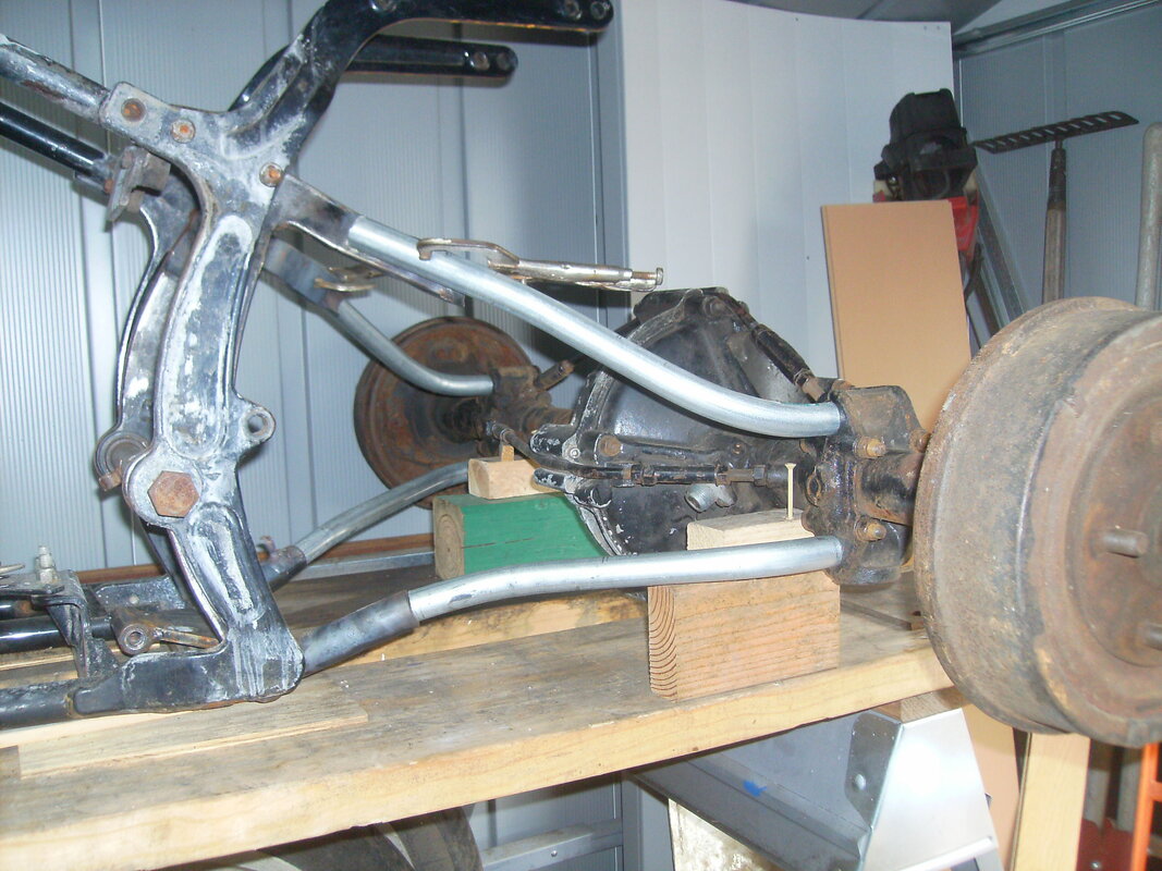

I'll dig up the pic's. for you later. I used conduit to make up my pattern then did the final build with seamless tubing, plugs in the joins on the bottom. Don't remember the #'s. of the tubing, but can get them if you need. I'll get back later today.

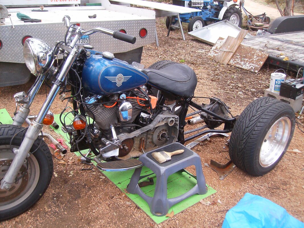

SANY3276.jpg I just cut the V off of the swing and went from there. If you look close at the bottom tube you can see the joint, the top tube I mated it just as it was stock. I'm still lookin for the pic's of the actual fabrication.
SANY3276.jpgThought I posted this pic. earlier. If you look close you can see the join on the bottom tube, top tube mated same as original. I have more pic's I'll look tomorrow,it's been a busy day. This is softail not ridged.
Oop's I guess I did.:xzqxz:
