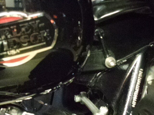

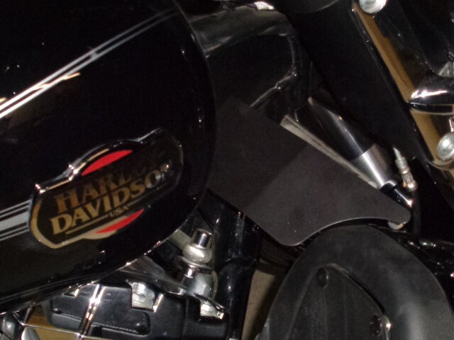

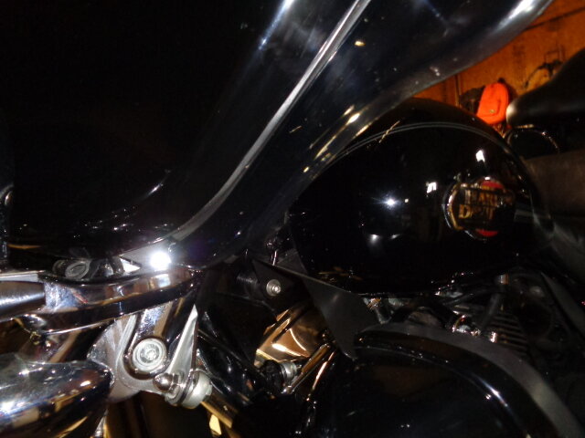

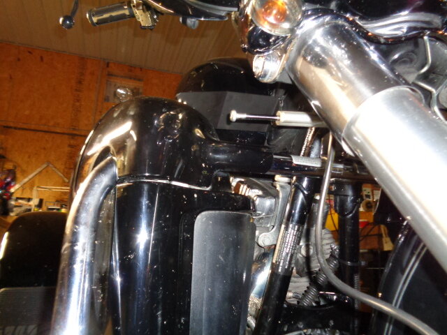

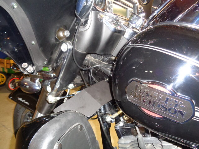

I agree way to much air so I lifted tank in front 2" and rear 1/2" made a huge improvement for me. This also puts more air on motor runs a little cooler. Makes rocker boxes easier to polish and keep clean. DK Customs among a few others here have lift kits available from their website. Also I really like the air deflectors just developed this summer, they really ended the glasses dance for me. ThumbUp ride safely fred
