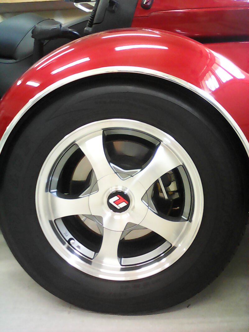

Does anyone know if anyone is making fender well trim for the Gl1800 Champion Trike kit? I can't seem to locate it but I have seen photographs of Champion Kits with it installed on them. Thanks
Fender Well Trim
If Champion doesn't offer it you might try an automotive trim shop or paint distributor for it. Most of it is made by 3M. :clapping:
I bought the 3-m chrome edging with strong adhesive at a auto supply store for my Roadsmith and I like it.
Originally I was looking for the u-shape snap on trim, but this works just as well.
I also use some pin-striping that looks sharp also.
Thanks! That is what i will do.
:0)
The buddy of mine who was a Lehman and later, Champion Trike converter / installer always used "Protekto 37-353" on the Champion conversions. I liked it and he gave me some ..... though I have yet to install it on my trike's fender openings. I do have it on my trailer's fenders ..... been stuck there since before 2004 at least and there it's formed around some really tight curves.
Clean any area well before install with alcohol twice .... and it wouldn't hurt to use some prep spray that really cleans all trace of wax off.
There are other widths besides this, it's got a really good adhesive backing and all I've seen stays stuck.
http://www.repaintsupply.com/cow-37-...ing-p2553.html
I've ordered other trim from the same outfit, always fast ..... but you might check your local automotive paint and supply outlets.
Most auto part store has the trim you can put on your trike. I like chrome and I have used it on my trike and several other vehicles I've had. As long as you clean the area you are going to attach it to, it will stay on without any problems.
Thanks for all the feedback! I appreciate everyones input. :)
When the weather warms up a little. I will hit the auto store up for some trim.
