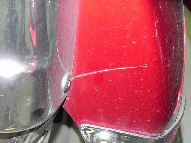

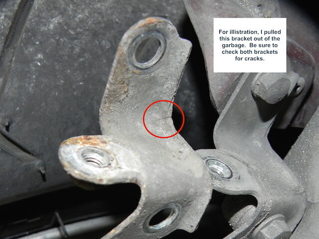

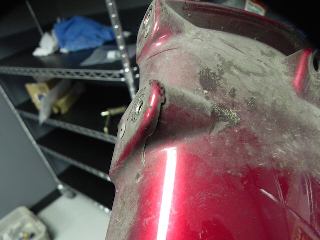

The other day, I replaced the back part of a front fender, and the customer had stated "this will be the 4th time its been replace. The last time I had the rubber part of the extension cut off, and it's happened again."

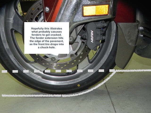

Since I see so much of this, primarily on trikes, I felt the need to share what I know. First off, in the 2 wheeled world, there's one lesson most 2 wheeled GL1800 riders quickly learn ... that GL1800s like pavement, or they fall over !!! However, since trikes don't fall over, trike riders seem to forget that rule, and I often see them leave the pavement to complete u-turns and such. Here is what probably happens, and how to correctly assess the damage for a proper repair. Most DIYs can easily replace these parts.

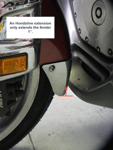

At the base of the arrow below, is crack.

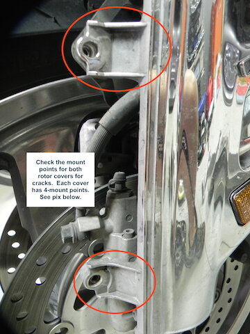

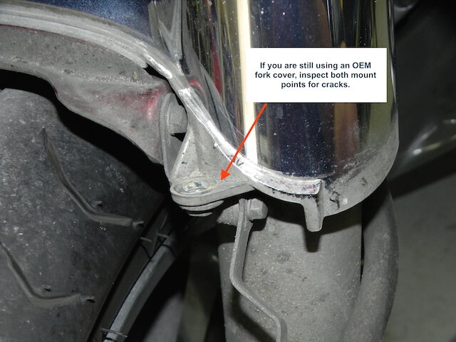

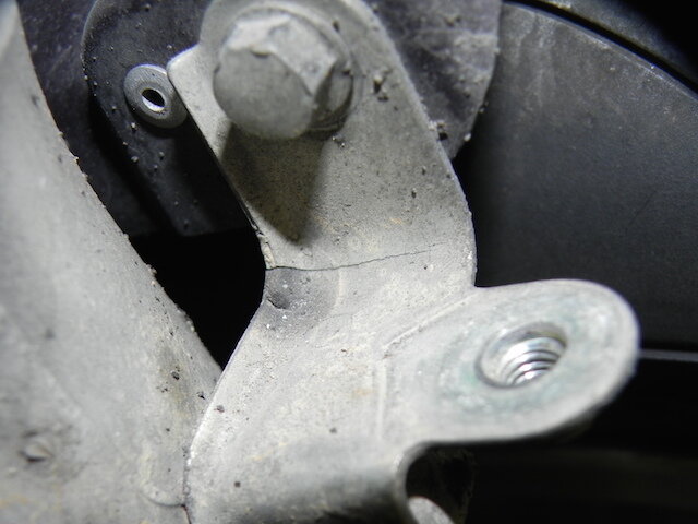

More parts to check

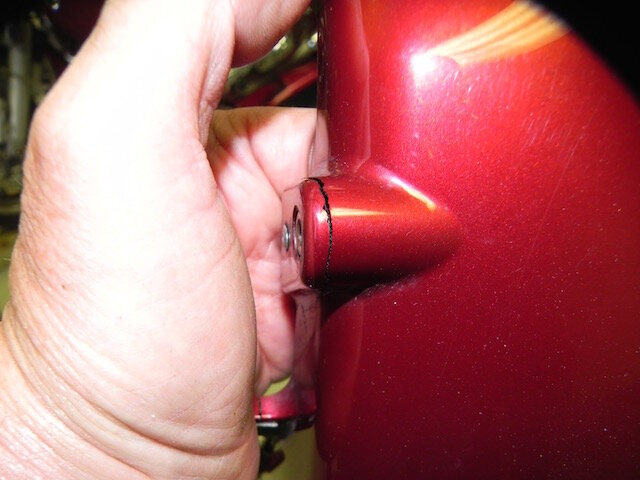

This rotor cover has no cracks, but I've seen damage in the read area, so don't forget to check for them.

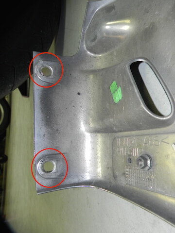

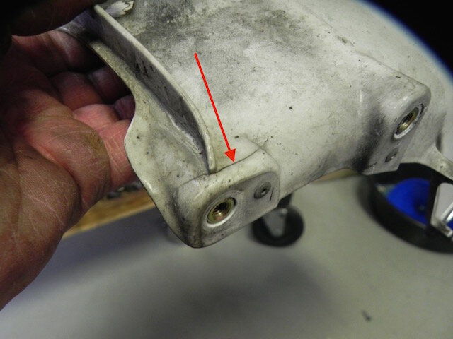

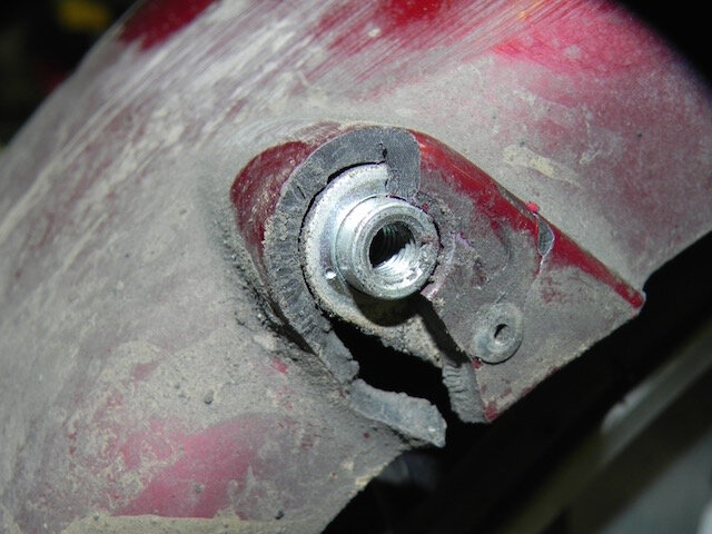

Here are the rearward ones. Often I find cracks around these mount holes.

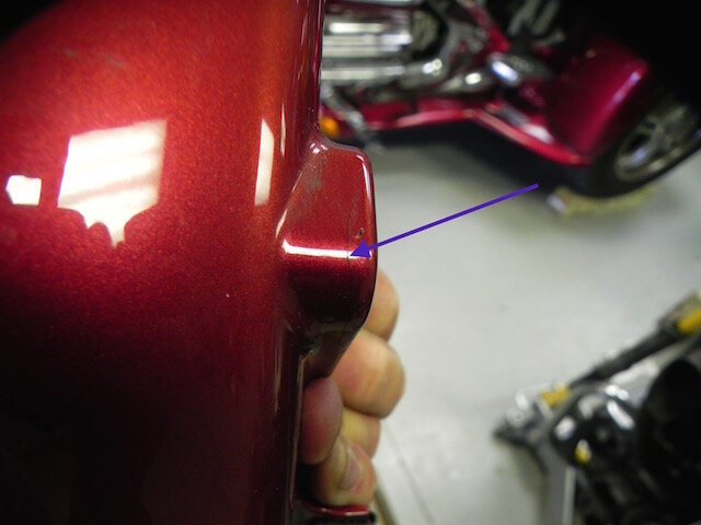

In my world ... I've seen 1 fender broken that had an OEM Hondaline extension as shown in the 3rd picture in the first post. However, just last week, I replace 2 fenders that had longer extensions on them. Finding one broken, is so common, that I wish I could afford to stock all fenders in all colors.

The chances of you having a problem with a Hondaline one is little to nil.
Interesting ... today a 2-wheeled customer, who had a long extension, says his lower front fender broke after he went through deep water. I never considered that as a possibility.
I used front fender extensions in the past but will never use one again. I'd rather clean a little dirt then pay for part of a fender. Think carefully before you install one. Especially if you ride over rough roads

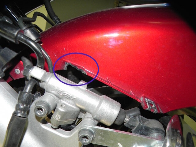

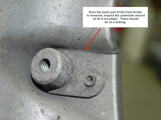

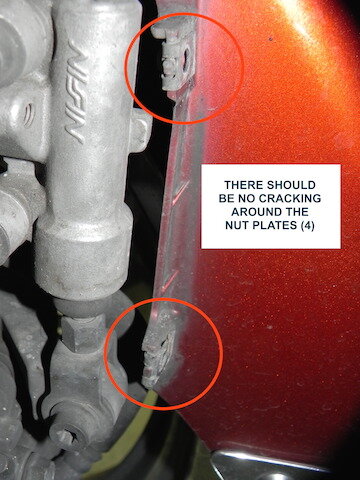

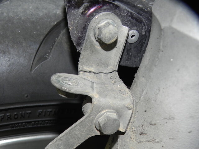

This customer came in for a fork overhaul (OH), and after removing the upper part of the front fender, this is what I found. Apparently, a few weeks ago, the rear part to their front fender was replaced by a dealer up north. It appears that the dealer did a poor inspection of the total damage. Their fork OH included replacing the fender stays.
