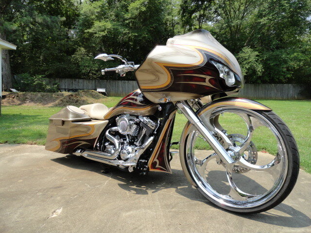

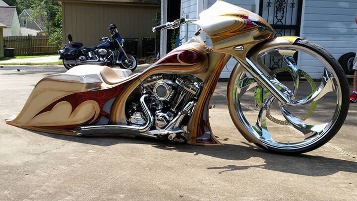

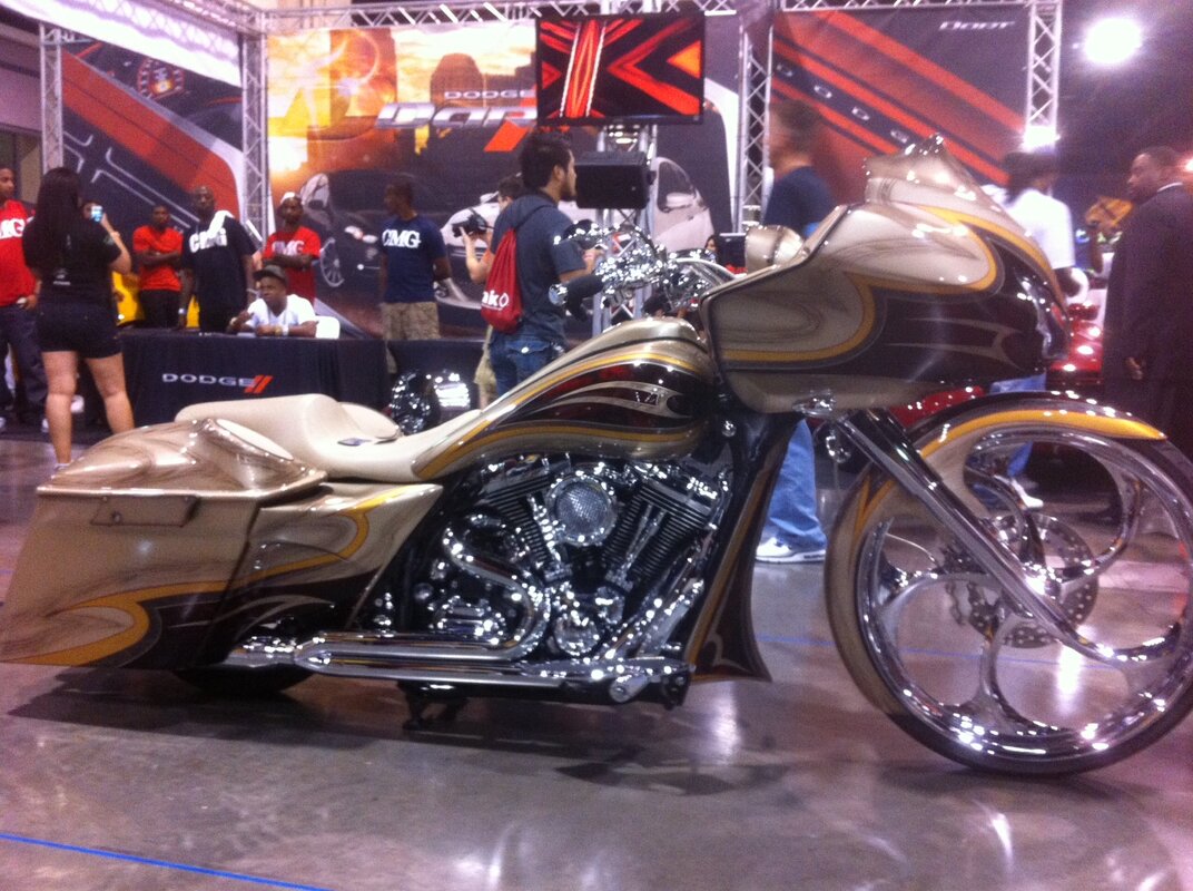

Some of my past buids and my experience with the road glide custom build fairingsiphone pics 118.JPGg3.jpgDSC00021.JPG
