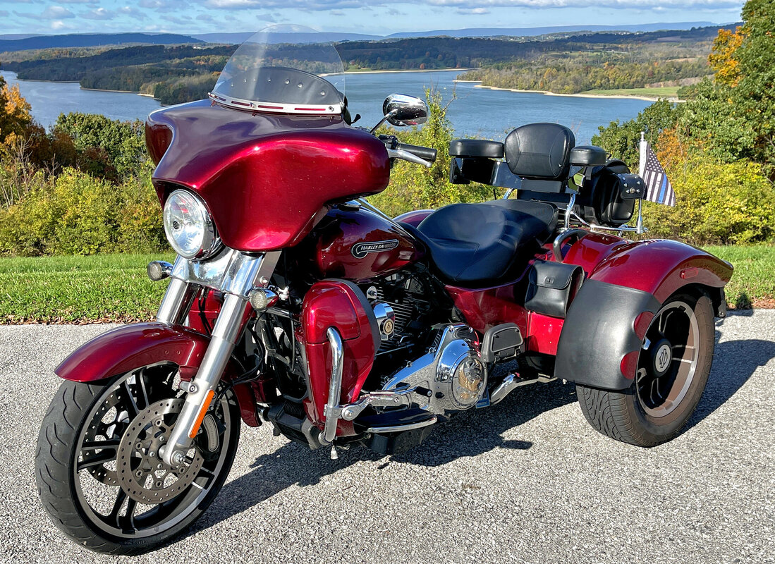

I have the Reckless fairing with radio installed and have seen some nice ones from Memphis Shades.
The one in the attached photo is mine.

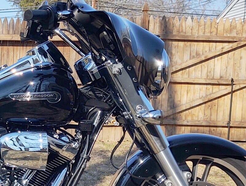

Does anyone have any pictures how these fairings mount to the bike? Any that use the standard Freewheeler points? DW doesn't want a radio or anything else in the fairing.
Every one I've seen, including my Memphis Shades Batwing Fairing, utilize the factory HD mounting points, but you may have to unbolt the 4 acorn nuts and replace the round, grooved washers with the ones that come with the fairing. That's how mine worked anyway. No big deal, they come right off.

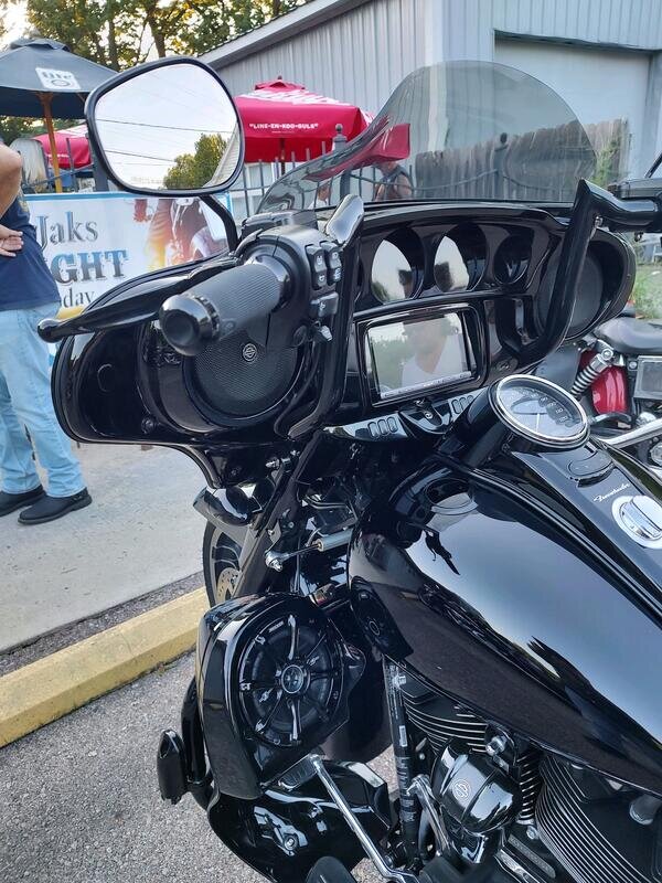

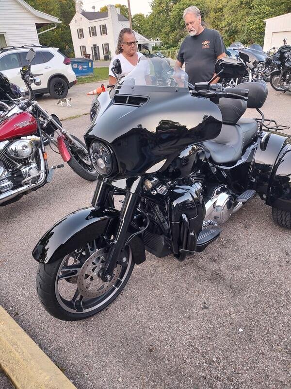

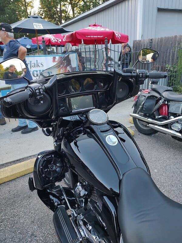

My buddy installed a factory Street Glide fair onto his freewheeler .what he thought wouldn't be a big deal turned into a fairly large undertaking. Had to fabricate custom brackets , first he got a set of tri Glide trees thinking that would work, nope they are different than street Glide trees. And they are even different than Freewheeler trees, but the finished product is one beautiful freewheeler. I will have him send me some pictures of it tonight.
....Had to fabricate custom brackets , first he got a set of tri Glide trees thinking that would work, nope they are different than street Glide trees. And they are even different than Freewheeler trees, but the finished product is one beautiful freewheeler. I will have him send me some pictures of it tonight.

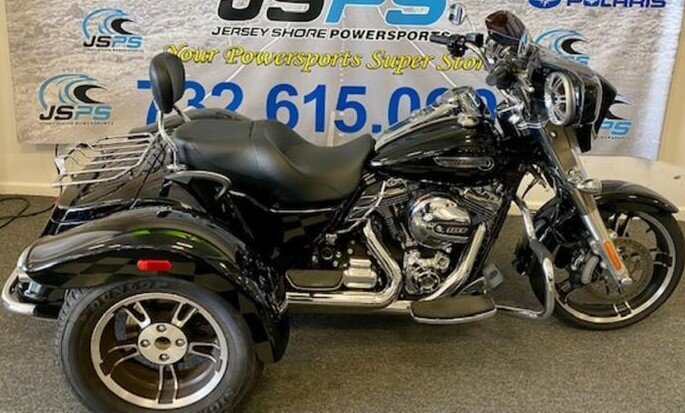

Hi Larry, Just picked my trike in NJ last week. It came with a fairing. I believe it is a Reckless Mfg. It has a Kenwood Radio and 6x9in. speakers. Still have to make my mod's yet. Its a hard choice. Ride Safe.Freewheeler1-2.jpg

If it did not come with floorboard extensions, that's my first suggestion. I got mine from DK Custom Products, they are a TT sponsor. DK Custom Products
Congratulations
Hi Larry, Just picked my trike in NJ last week. It came with a fairing. I believe it is a Reckless Mfg. It has a Kenwood Radio and 6x9in. speakers. Still have to make my mod's yet. Its a hard choice. Ride Safe.View attachment 109418

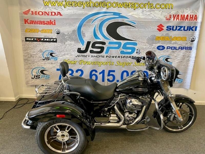

Congratulations on your purchase.
I had just emailed JSPS yesterday about this bike, guess it's off the market.
Wonder if other two units are still there???
Nice looking ride. How does the radio sound at highway speed?
How is the air flow behind the fairing? I'm trying to decide if getting a fairing is worth it or just go with a recurve windshield and fairing fangs.
I'm getting beat to death on the highway the way the bike came. Its a good thing I installed a riders backrest the wind keeps trying to push me off the bike.
