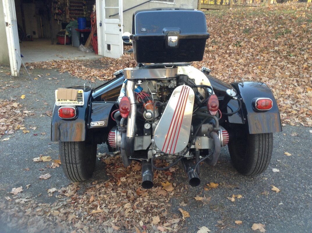

image.jpeg hit the wrong button sorry. ipad is useless anyone have a good plcture of this exhaust from the side. Want to see how far back it extends.
Picture of exhaust I need 2 replace

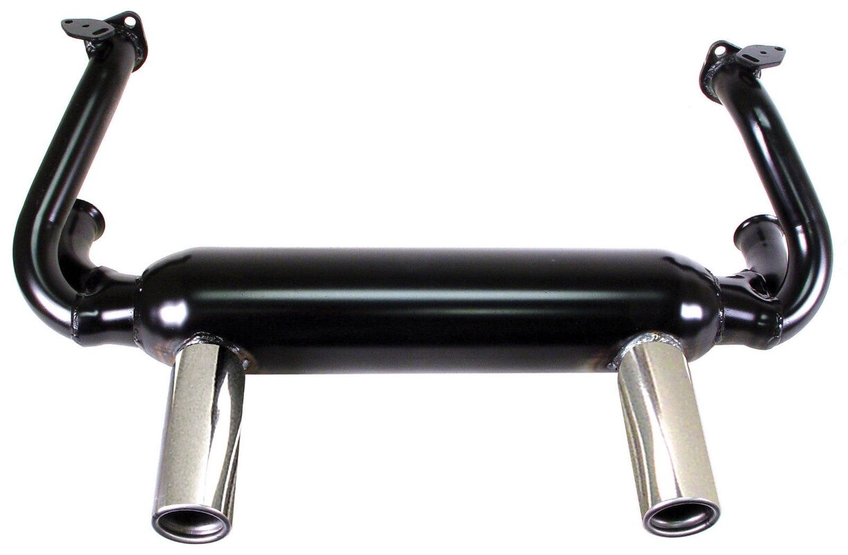

I'd like 2 replace this with something similar. Found something almost the same but it discontinued.

The lower tubes are designed to fit into the heater boxes or "J" tubes so they don't go back all that far. JC Whitney used to sell one like that try there to see if they have a side shot.
Don't have a photo, but from the rear exhaust port(s) the 'muffler can' protrudes 10", plus the tips extend another 6" from the can - 16" overall from the exhaust port(s). As mentioned if you go with this type don't forget to seek out some matching "J" tubes. I'd love to have an exhaust that exits under the motor as you show, but I haven't seen those available anywhere.

Don't know how that new exhaust you're looking at would fit on your trike without modifying some sheetmetal around the rear exhaust ports.
I was running a similar exhaust on mine with stock tins, & it even fit ok with the extended autostick specific oil/transmission pump.
Not to discourage you but after I ran it awhile I didn't care for the low hanging look/sound, & switched to baja style mid engine height pipes.
What's wrong with what you're running now?
Well that exhausts been on there since 72 so rust time have taken their toll. They've been repaired a few times. I've seen systems similar to mine but they don't seem 2 be available anymore. I think its cheaper 2 buy one than make it. The parts cost more than the complete exhaust system.
Is the exhaust you have plumbed in using drilled in fittings into the tail pipe?
If so, are they important & do they need to be drilled out to retro~fit onto a new system?
