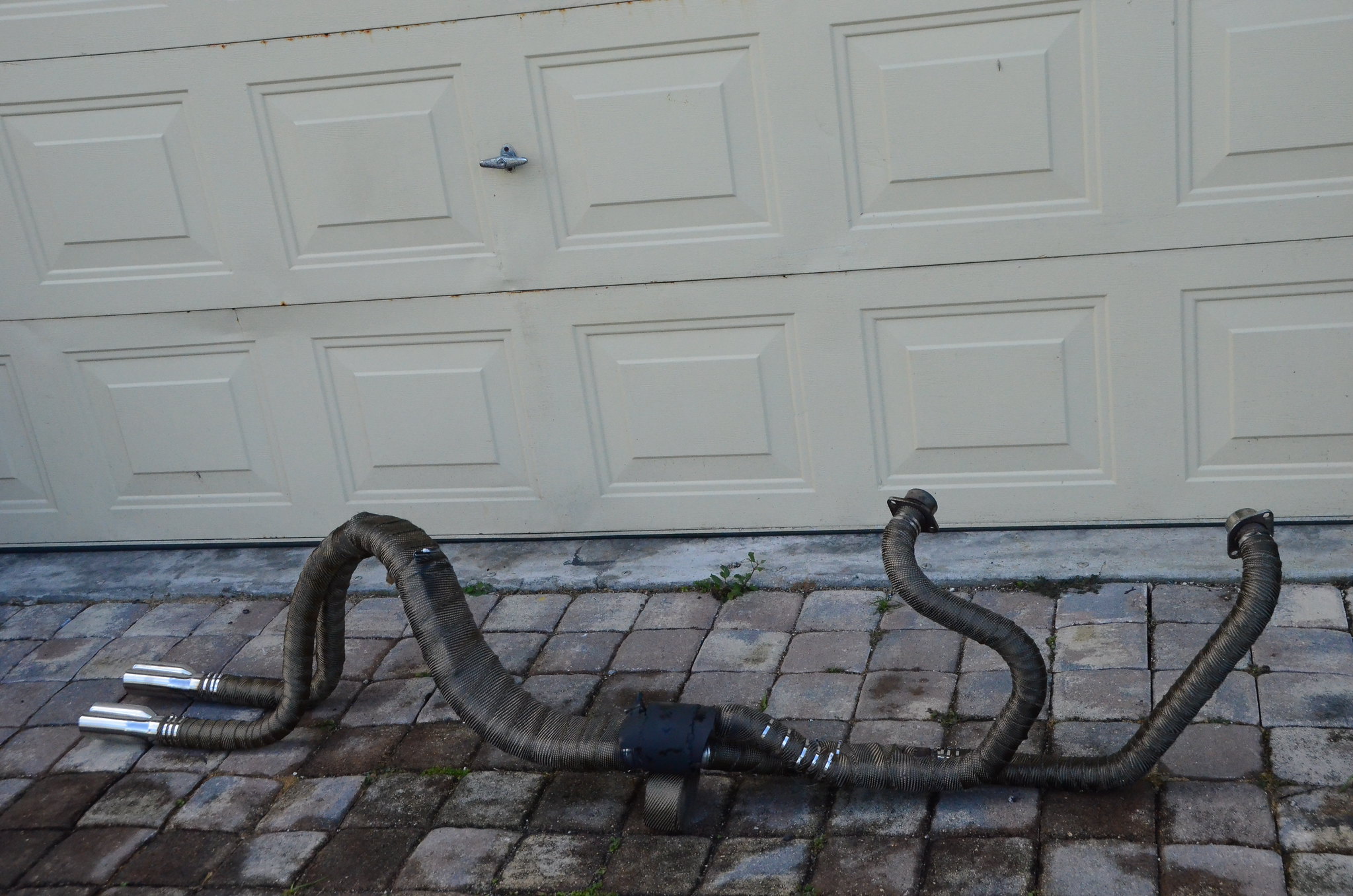

I got that goal via reducing noise. Dual pipes, 4 baffles and 2 'DB killers'. We can hear the cicada bugs in the trees as we ride. Ride by the local golf courses, and players dont even look up. Absolutely love it. GREAT low end torque, and enough power it tore 1/4" steel on the rear axle. :xzqxz:
Only 'down side' is that you hear EVERY single rattle and noise on the trike. I have tracked down most of them. :clapping:

If quiet is what you are after, make things quiet. :) That was my goal, and I am VERY happy with results.
