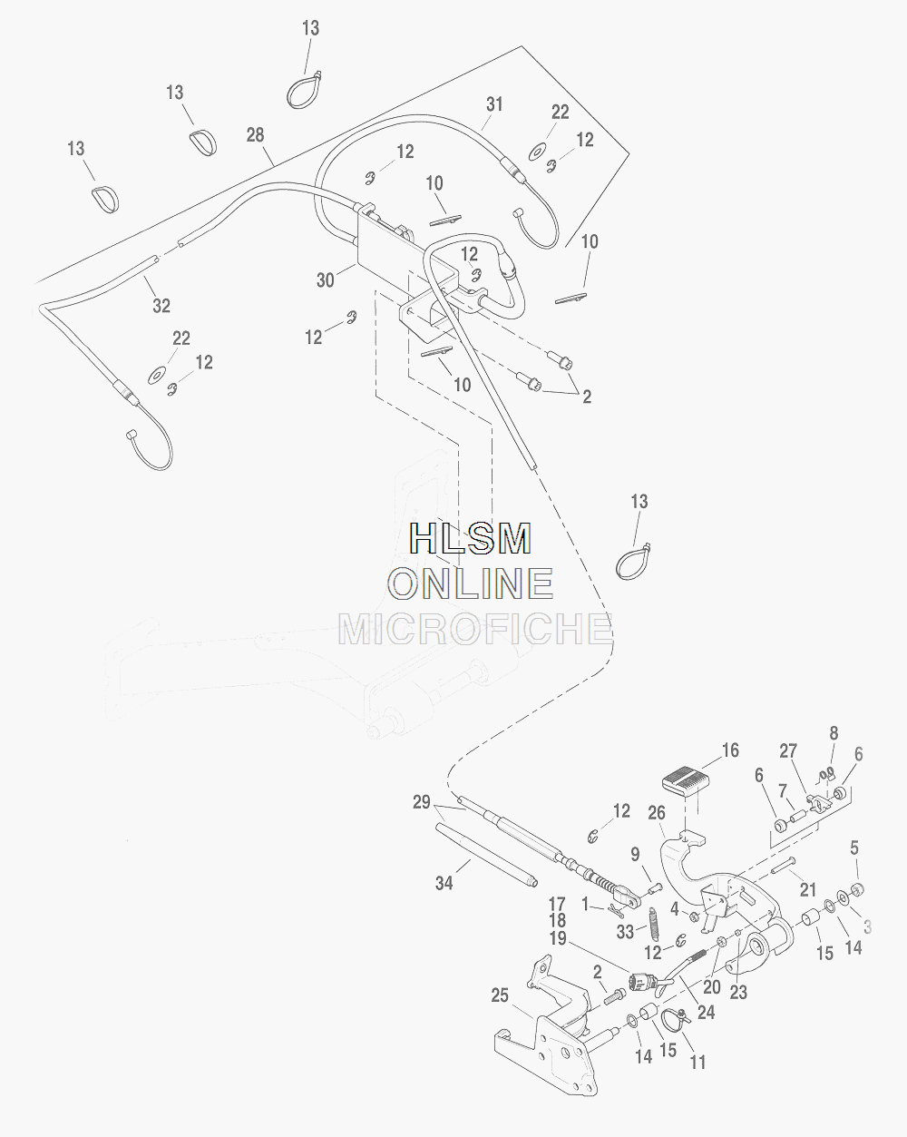

New to the Trike world an don’t have my shop manuals. I need to replace my emergency brake light sensor, need help to locate it to R&R

Its on the inside back of the brake assembly, Its a push pull rod with a loop on one end and a small magnet that makes contact with the assembly...Maybe you might have gunk on the magnet and its not making contact with the assembly..:Shrug:...
Look under the LS floor board, you will see the switch and the wiring
# 24 below is the wiring and switch
Before you replace the switch pull up on the pedal, does the light go out?
If it does adjust the parking brake cable and lube the assembly
