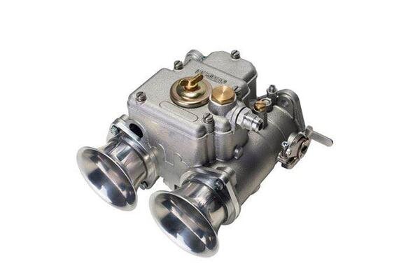

This is a product distributed by Fox Injection. Does it look familiar?
It is called the Heritage Throttle Body and is designed for classic sports car builders/restorers who want the fuel management improvement that EFI affords with the look of the traditional Weber DCOE style carburetors. This carb was used by lots of custom bike builders in the 70's and 80's. It comes in four of the sizes most commonly used by classic car owners; 40, 45 and 48mm.

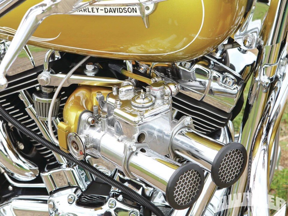

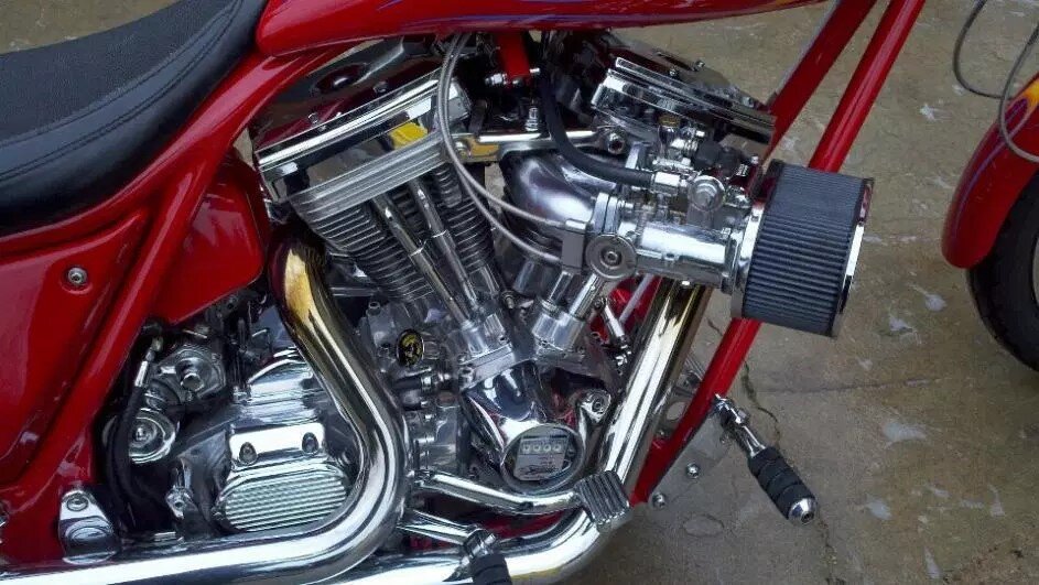

Hmmmmm......
..... I wonder how a big bore M8 would like drinking from straw like that....

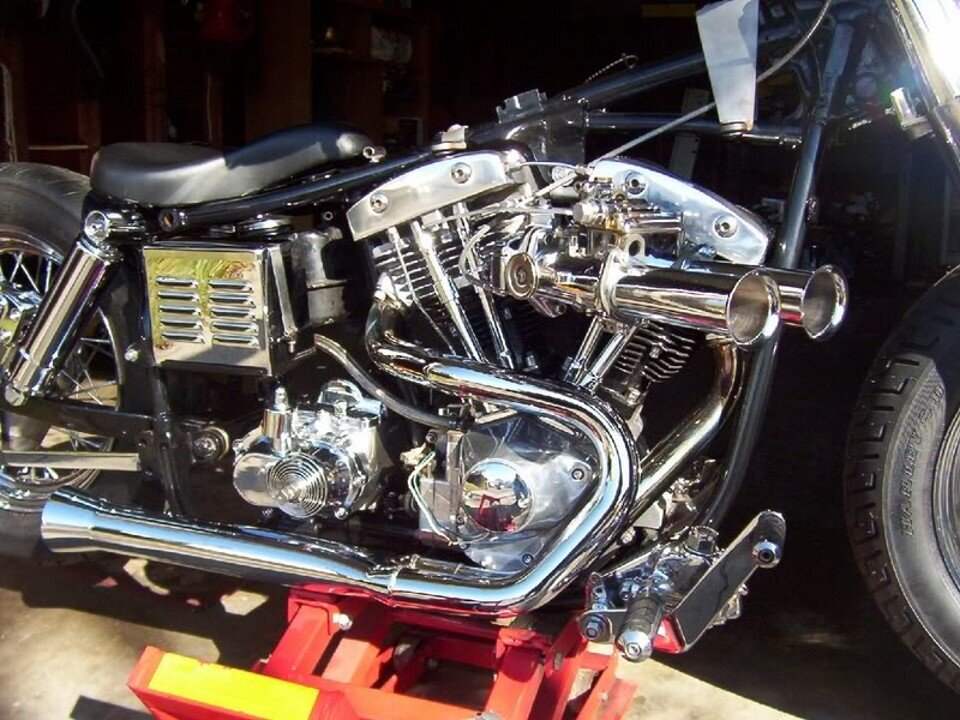

Yep. I think the S&S two throat was their answer to the popularity of Delorto's and Weber's popularity at that time. LOTS of builders and racers used them. Me included. I had a Weber with 6" velocity stacks on my long bike. It was kinda like this one...

Well.... A little more homework and many phone calls to folks who really know EFI tuning for the HD Motor (especially the M8) have given me great guidance on this idea.
The short version of the story is.... BAD IDEA
The (plastic) Manifold on the M8 locates the injectors right at the ports into the head. This is where they must be located for fuel/air mixing and mass balance of the fuel's delivery to the fore and aft cylinders to be maintained. The DCOE throttle body concept in the pictures would place the injector many inches from the port. 100% of the folks I talked to advised that I was asking for major imbalances and fuel delivery issues between the two cylinders. Not to mention the fact that a 48 DCOE carb on a 74" or 96" Shovel is not comparable to the needs of the big bore short stroke M8 in volume (grams of fuel/second) or air flow dynamics....
They did say that I could make a manifold to connect the DCOE look-alike throttle body to the stock fuel injector assembly and have essentially a really fancy air box with butterflies... But I kind of think of that like I think of the fake kickers CCI used to sell for electric start evos back in the 80's or wearing a tuxedo t-shirt in your wedding....Its just not right. So I am abandoning any further pursuit of this idea
