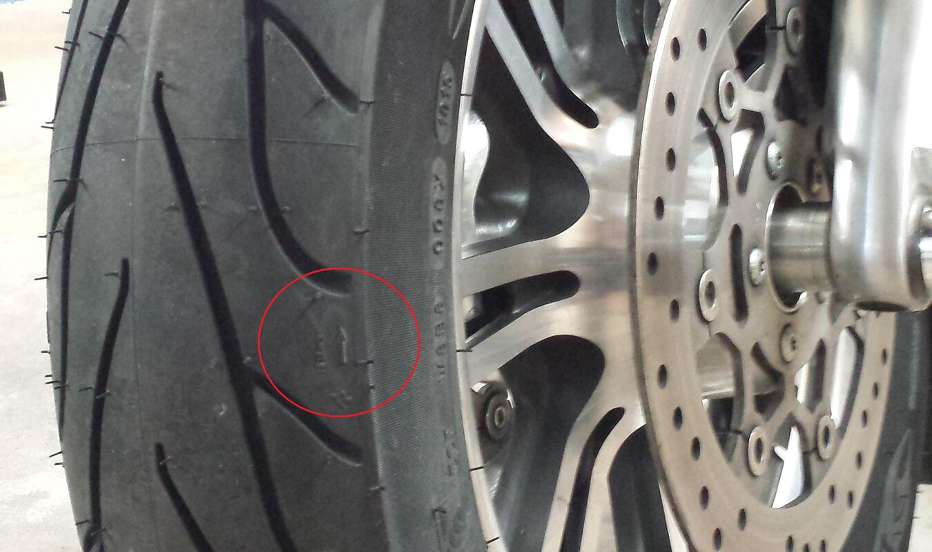

I went with a Michelin Commander II rear tire and mounted it backwards. Many miles, still looks new. I've done this before and you can be sure to get LOTS of miles.

What's the rationale behind running a rear tire on the front backwards? Especially the backwards part?
Enquiring minds want to know.
Being the front wheel needs to be a rolling grip, by runing it in reverse eliminates the need for tread grip on excelerating hence a smoother ride and no cupping. Michelin scooter tires are all reversable with tire rotation arrows. How did i do in splaining Lucy!!
I think it has more to do with the way the tires are construed [Bonded layers] ' If you use them in the front and don't reverse them they can come apart internally...
Thanks for the link to the article Zammy. My local shop explained it basically the same way but didn't say anything about how the splice was put together. I leaned something!!!
That's right. I think it was AVON tire company that issued an engineering memo about running a rear tire on the front and the need for it to be reverse rotation to what it would be mounted on the rear. You can probably google it? Ride Safe! I run a rear Dunlap E3 the same size as a normal front tire on the front of my Trike reverse rotation, 30K miles. Give one a try??

I have a 2012. Did you have any fender clearence problems. I noted groves in comander 2 ftront are 4mm,rear is 8 mm. How does it handle hydro planing? Thanks Ray
