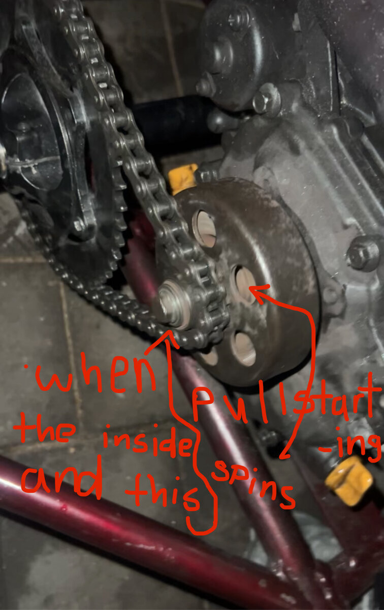

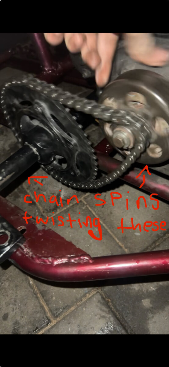

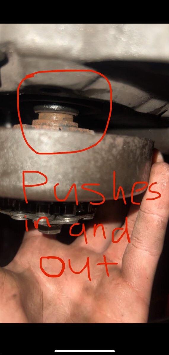

So my dad spun out and and hit the wheel on one side and pushed the axle in, bent the brake disc and cracked both rims so ive taken it apart and fixed everything that was needed but when i put the chain on and try pull starting the sprocket spins but the chain does not, chain does spin when spinning axle or tyres or whatever but not when i pull start. i have a video that explains it but i can only upload photos so ill try my best im still new to all of this so bare with me with the names of certain thingsIMG_0758.jpegIMG_0760.jpegIMG_0761.jpeg

thats the thing i have no clue its has 1 cylinder only 1 gear centrifugal clutch i bought it from a friend but all i know is that its a drift trike unfortunately
Like what my kneesbehurtin said the inner part of the clutch that sits on the shaft most likely is keyed to keep from spinning.
You would have to take whole clutch assembly off the output shaft of the motor.
In the shaft should be a slot for the key to slid into the shaft to hold the clutch from spinning on the shaft.
This key is to protect the motor output shaft from twisting from an event like you said happened.
Knock the broke key out purchase a new one and reassemble the drive gear.
Should be able to do it yourself.
GOOD LUCK and welcome aboard
Broken ( sheared) key, take this apart, check the key way for damage, you may have to dress it with a file
If the new key you will be inserting fits loose try some loc tite on it
Good luck and do check back in
