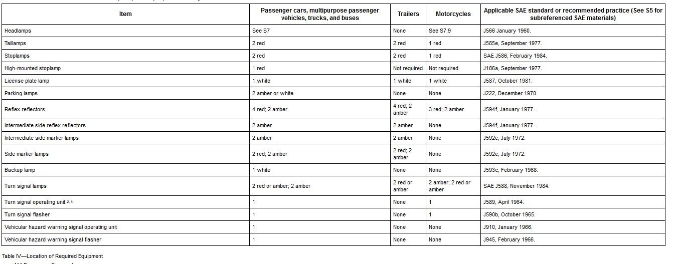

I had already found this code, and gone through it to determine the lights are not complying although they are marked as such. Anybody can put the DOT code on any lamp, so I don't get your angle (pun intended).
1- Marker LAMPS are not required but reflectors are in their place.
2- This table is for all vehicles, cycles not excluded.
Figure 1c—Sum of the Percentages of Grouped Minimum Candlepower
Group and test pointsTurn signal StopParkingTail
110U-5L, 5U-20L, 5D-20L, 10D-5L65656070
25U-10L, H-10L, 5D-10L12512575120
3H-5L, 5U-V, H-V, 5D-V, H-5R475475420480
45U-10R, H-10R, 5D-10R12512575120
510U-5R, 5U-20R, 5D-20R, 10D-5R65656070
