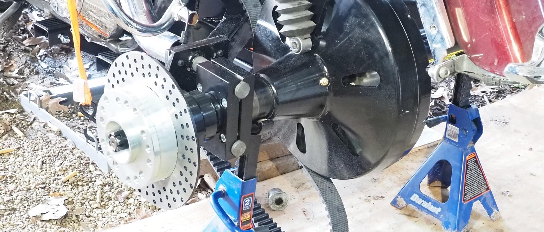

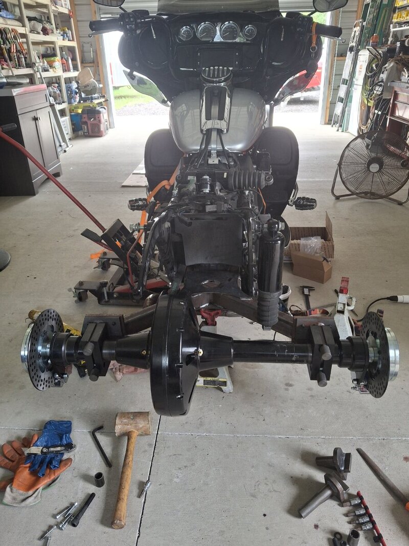

Im trying to change broken belt on my Dna trike,ive undone all the bolts in the rear drive pulley housing and the grub screws holding the housing to the axle BUT cannot separate housing to fit my new belt???What do i do? or is it maybe corroded into place on the axle?Any help would great,cheers all,Jon

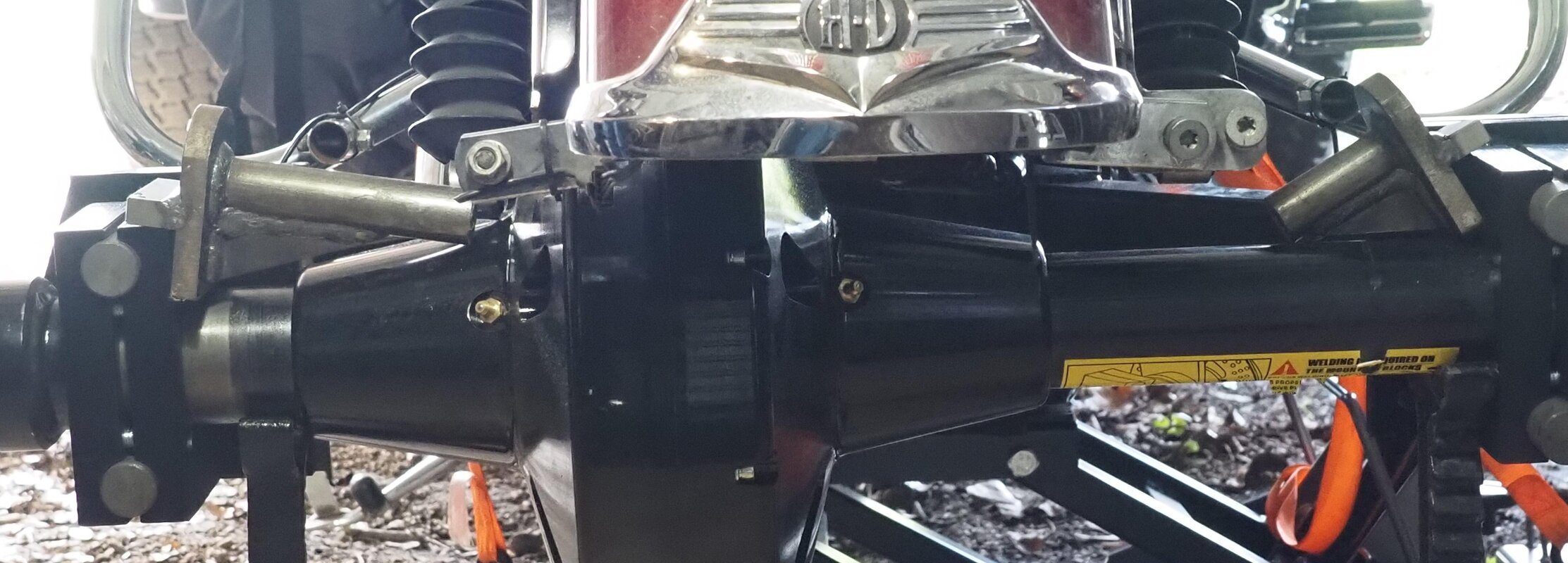

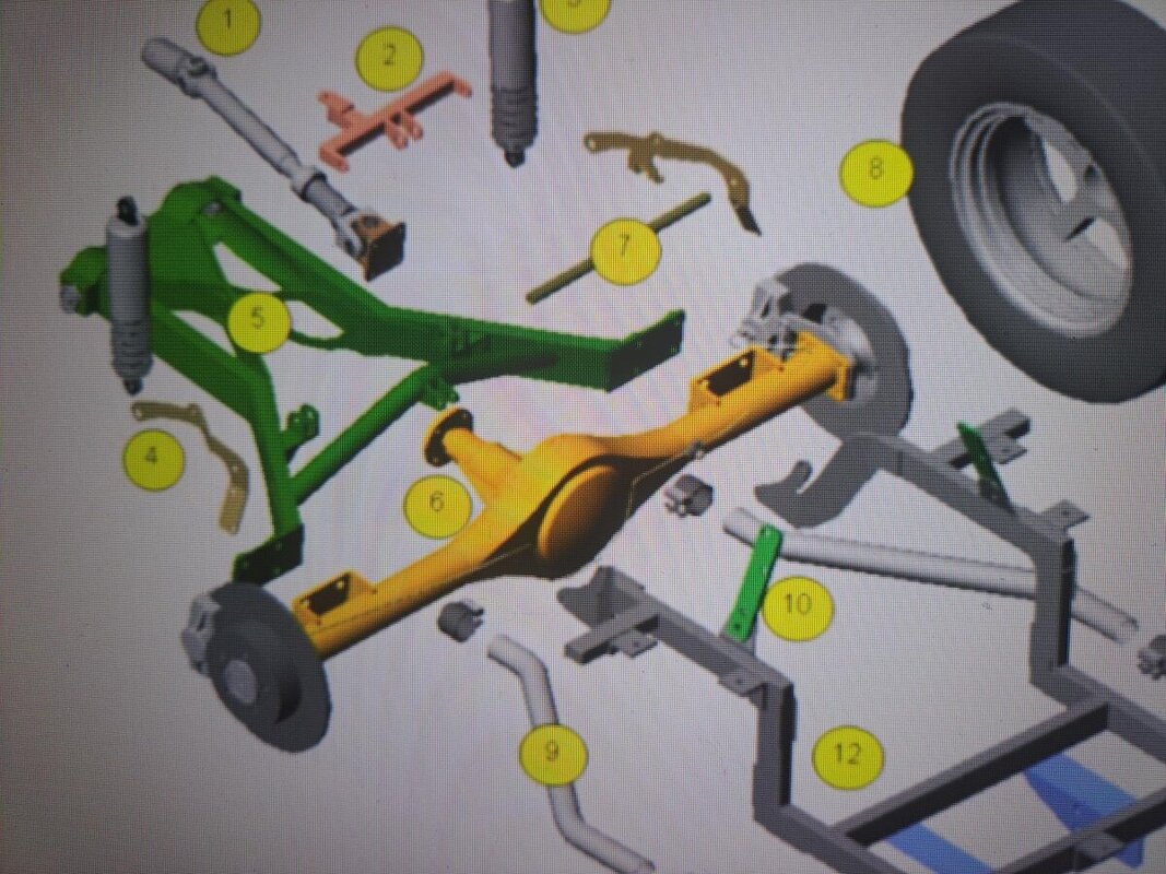

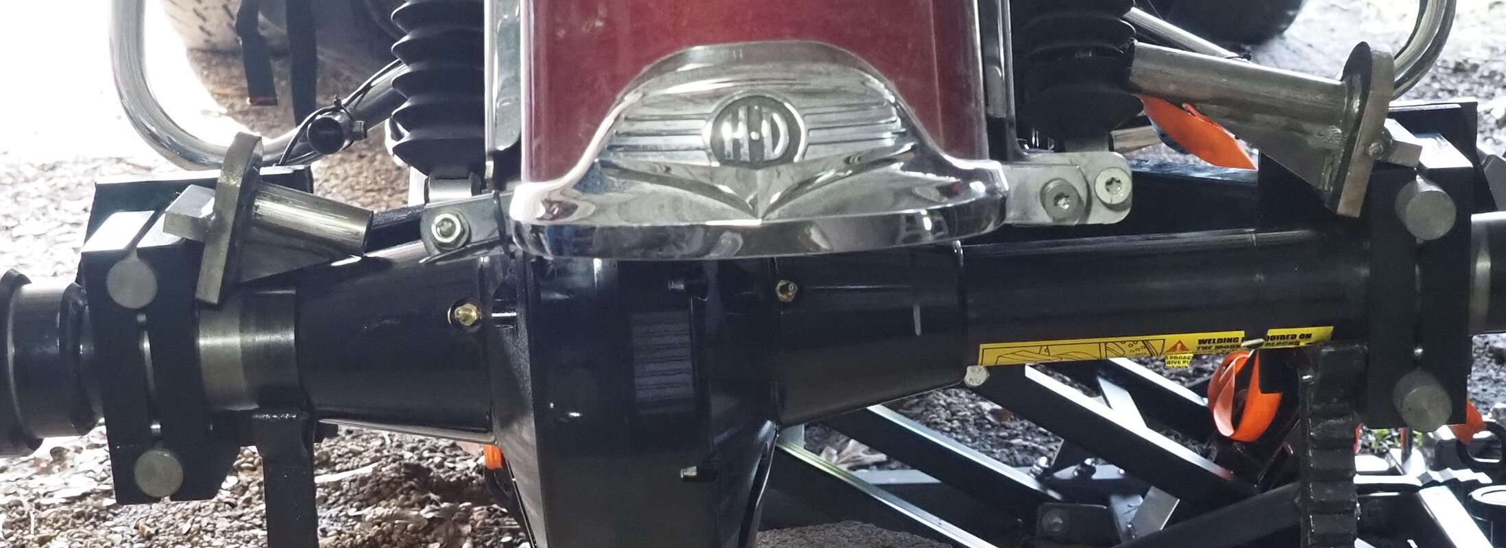

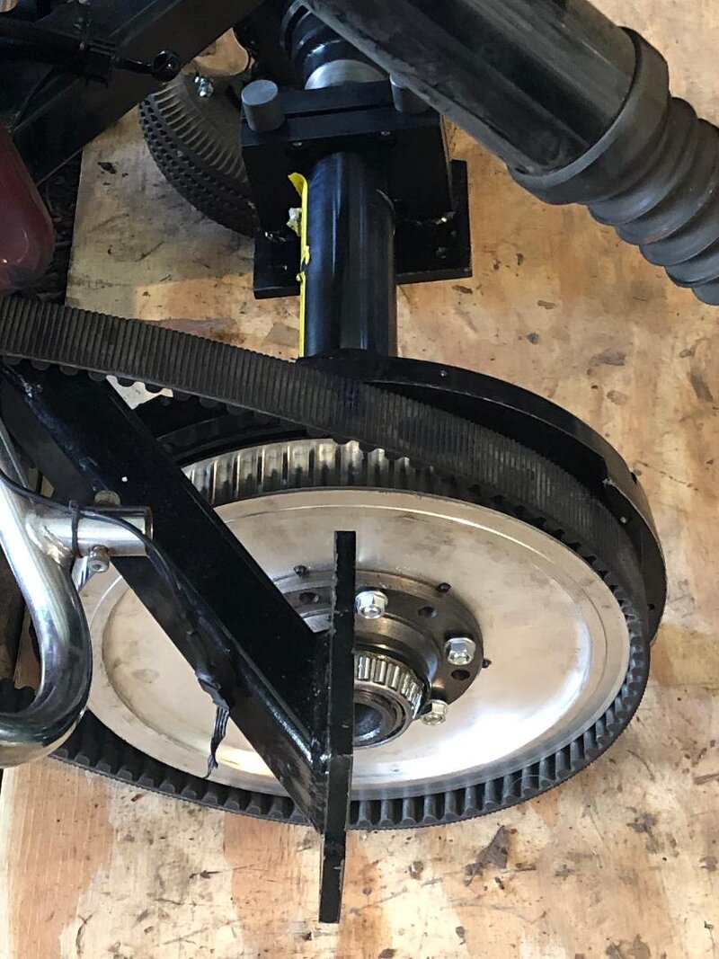

I’m converting a 2002 Road King Classic with a mototeks axel, same as the DNA, the biggest thing I need help with is the belt. Mine is a 70T 139T and the belt is short, it looks like the axel needs to move reward by about 2 maybe 3 inches I have no idea what belt size I need for it to work. As you can see in one of the pics the swingarm mounting plates are in the center line of the axel so it has to move back.
I’m having a few other fitment issues, I’ve searched and searched for pics of trike builds and there are very few videos or images to review, no images of shock mounts, alignment, or anything. It looks like I will have to use a spacer on one of the shocks, I included a pic with the axel brackets that weld to the axel in place, regardless of which side they are on it looks like a spacer will be needed, you can see in one pic the bottom of the left shock is against the pumpkin.
If I want to use my saddle bags do I have to relocate them, I believe Paughco trikes sells a relocation kit.
Any information or tips, pics, anything that could help me out.

Welcome Kelly,
Have you tried contacting Mototeks for support on your fitment issues? Was the kit you ordered just the rear axle alone or did you purcase the trike swingarm from them as well? And if so, did they not send the correct swingarm assembly?
Waiting to hear from Mototeks, will call them again Monday. I ordered the swingarm from them as well, I’m certain it is the correct arm. The belt being to short is the main problem right now, I hope they can tell me which one I will need and I’m having a hard time finding one I think will be long enough.

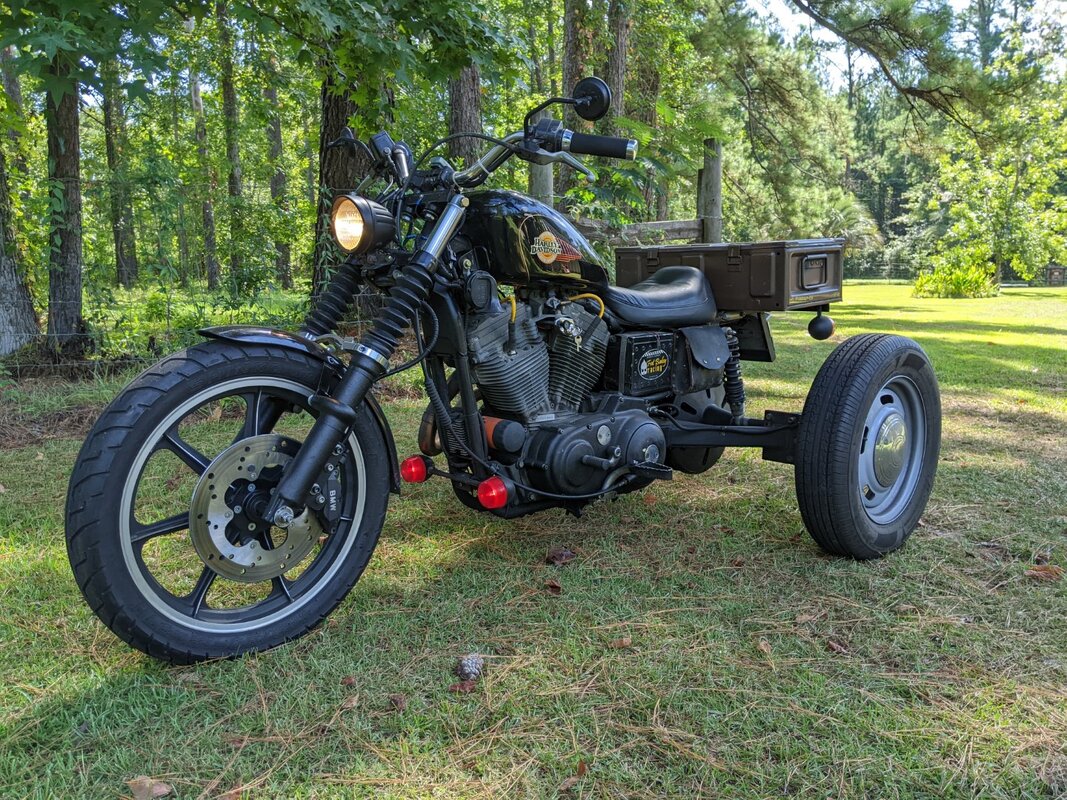

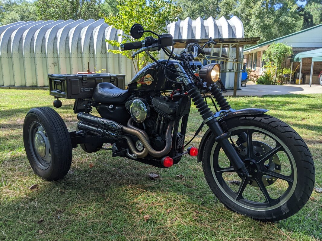

I installed a DNA swingarm and axle on a '91 HD Hugger 8 years ago and it has been flawless. It's not a kit, you'll have to do some welding, wiring, brake system designing and other fabricating, but you can make it what you want.
I rescued the bike from a friends backyard where it had sat for 3 years and built this because I'd never driven or owned a trike.
Here's what I built and it's a blast to run around in.

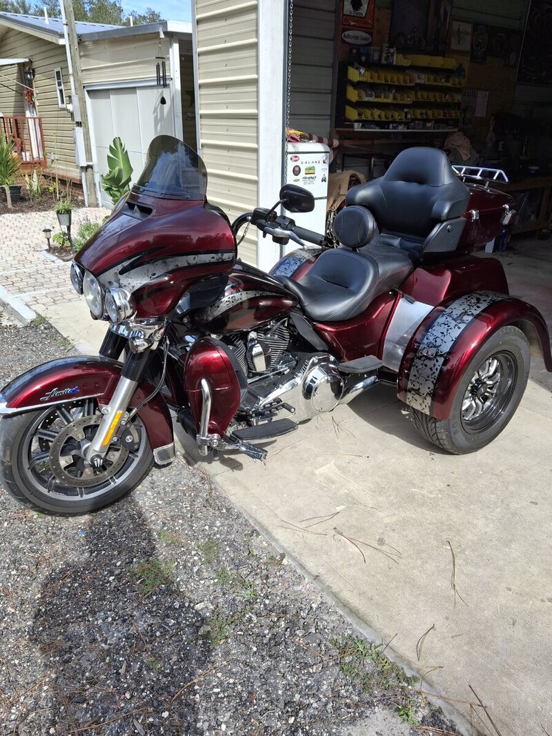

Hi, I converted my flhtk to street sweeper with dna kit. I am getting some issues with it wanting to dart left or right in certain rough road conditions. I replaced swingarm isolators with upgraded Drag Specialties versions; no help.
Question is- if I add a panhard bar (like tri glide) ,will it stop that "darting"?
A pic of the rear suspension would be helpful.Thats said if this is your first trike the darting may be you have too tight a grip or are tensing a bit.The slightest movement of your body transmits to the bars when you do that and results in a darting effect.Relax your grip arms a bit.
Thanks- yeah I have figured out the tensing up part, but thats not the issue here. I'll look for pics- the bike is all together and tough to get those pics.
I changed the triple trees to 6 degrees already.
Good Lookin Trike. Maybe you got the triple tree nut A bit to tight ? I had did that before and it gave it a weird feeling .
Thanks- I did think about that, but this is happening when a back wheel hits a ridge or dip and seems to try to change direction. Very strange feeling .
I have one other thing I forgot to mention- I used car wheels and tires. Since tge backspacing options were slim, U had to add wheel spacers, AND the diff is offset to get the belt lined up, so the wheel spacers are different thicknesses- 2" on left and 3" on right.
Could be they have upset the geomtry and causing so flexing.....

I feel like adding a panhard to this systen has to help- don't know why they don't come with the kit, for as much as it cost!
That swingarm setup looks like what Champion and others used.Here is a pic of what a Champion for a 1500 Goldwing looks like.No panard bar was used.The conditions that it acts up you are describing make me think your body motion is doing it.You may not even realize cause it happens suddenly but its very easy to do and takes several miles of experience to learn.Its like when a crosswind hits your body.Your trying to hang on andthe wind is trying to move your body sideways.You have to not move the bars while holding on or the movement will move trike around in the lane.For example if the right tire hits a dip it will move your body slightly right and cause you to turn slightly left.It can happen so fast you may not realize it.Its different from tensing up and I have a hard time describing it effectively.

Thanks Marc. I'll go ahead and ride it awhile and see if I can get more relaxed on it.
The champion on a Harley did not have a Panhard bar, they had brackets that went to the top center motor mount to stiffen it up so the motor mount would not brake, you could panel bond them or weld them. I did one that I panel bonded and it broke I road it home about 20 miles that was not fun. check the motor mounts ?
Well the rear motor mount is the swingarm pivot. I checked for and slop where it goes through tranny- all good. Rrplaced the outer rubber factory bushings with upgraded urethane ones. No change.
