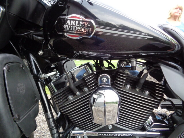

I went with the 2" deluxe when you install the kit I suggest keeping the tank as far forward as possible you will be amazed what a little adjustment can make with air and the seat position. I really like the tank lift. ThumbUp fearless
Thanks Fearless, that looks great! ThumbUp

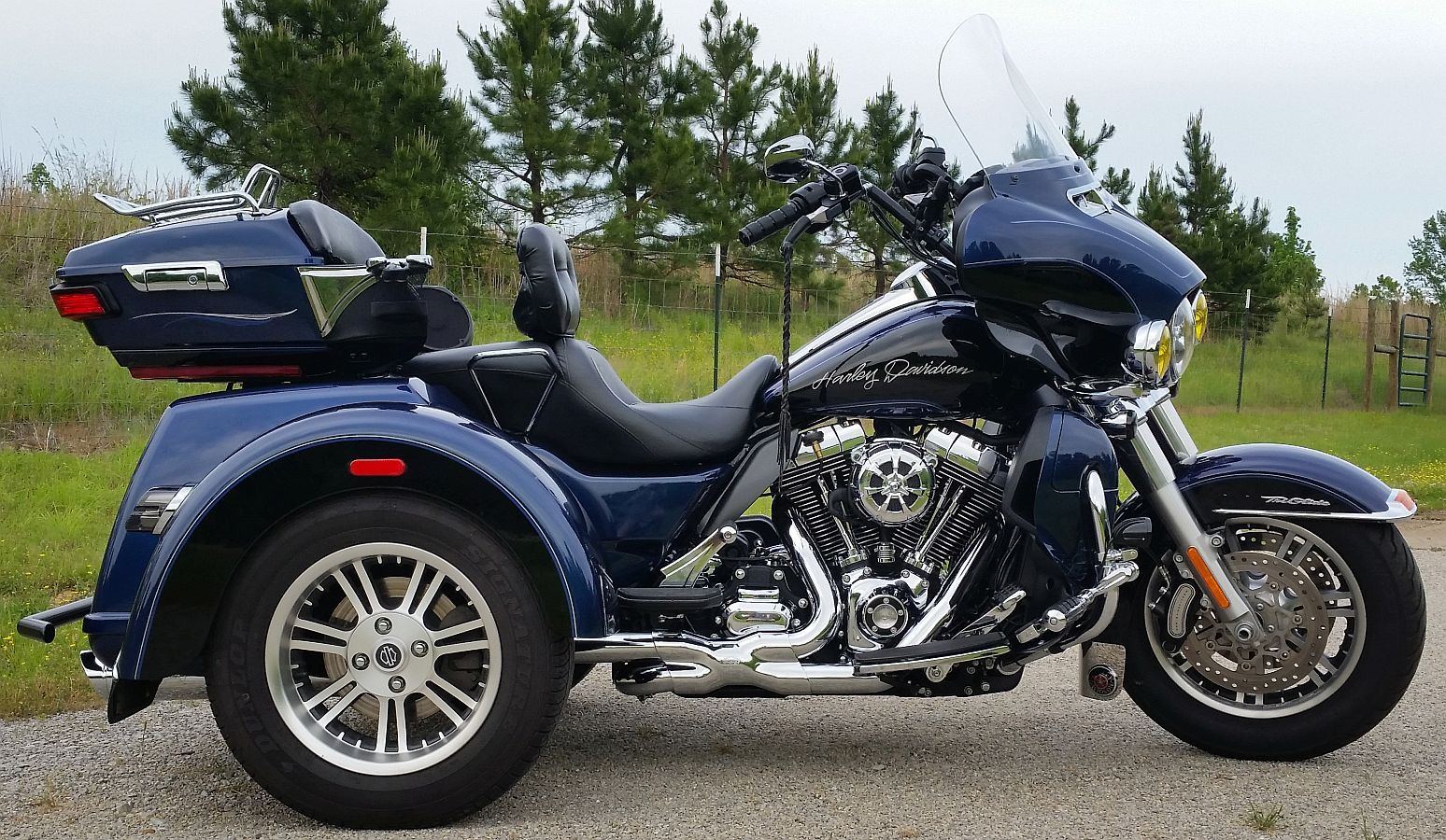

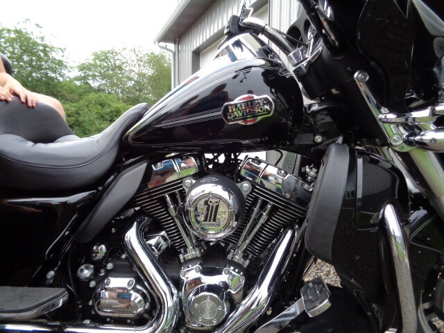

As has been shared, the seat goes on fine with a Tank Lift & deluxe option.
Regarding the seat tilt. It does lift the nose of the seat about 1/2". For most, they either don't feel the difference, or they feel the pocket is deeper/more comfortable.
However, there are about 1-2% that do not like the feel that the deluxe option gives the seat...in those instances they just run the tank lift without the deluxe option.
Here's a pic of my '11 with a tank lift and deluxe option, and below that one of my '14 with the same-
