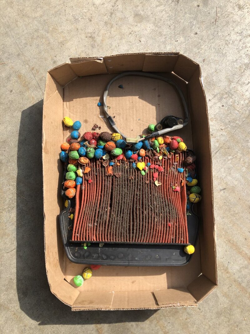

My first filter change, blew me away!
It was loaded with M&M candies, what surprises me the most is that I have NO children, and I live no where near any kids playIMG_0862.JPG
Time to check intake pipes for mouse nest

You must have picked up 9 miles to the gallon after that filter change. Is that the original factory air filter?
I believe my camera would have pick that up, like I said before it may not be great for just seeing the dirt but it will see bird and rat nest.
