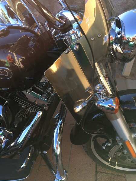

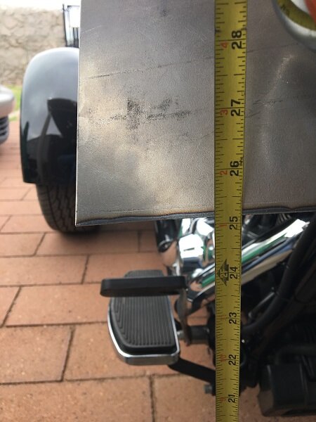

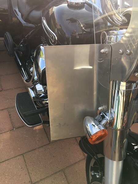

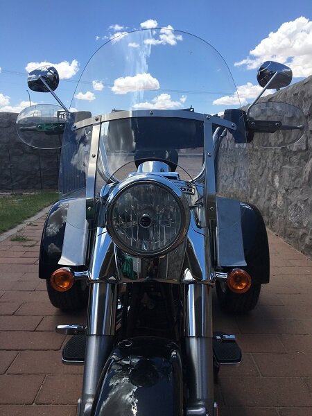

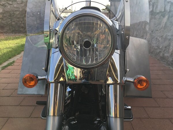

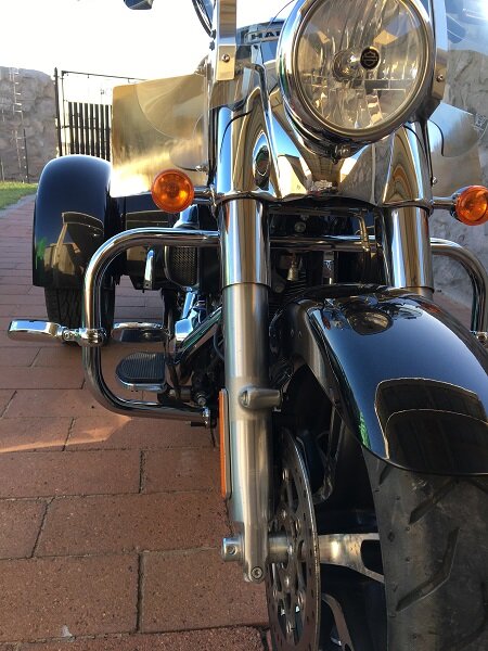

I just traided my 2014 Road King in for a 2016 Freewheeler. I have looked all over the net for Fork Wind Deflectors. JES wind defletors get good reviews but $170 is alot to spent. So I am making my own Fork Wind Deflectors. Started with 8"x24" 16 ga. flat steel. Cut in half to make two 8"x 12" pices. Drilled first hole 3/4" in from the top and side edge. The next hole 3/4" in from the edge on the 12" side. Next I made a rounded bend 2" in from 12" hole side. Then drilled a 1/2" hole 1 & 1/2" from the 2" bended side and 3 & 3/4" from the bottom edge. Made a cut 4" from the buttom edge on the 2" side to the 1/2" hole out side edge. Then made a cut 1 & 3/4" in from the 2" side from the bottom to the 1/2" hole out side edge. Rounded the edges next to the two mounting holes and at the bottom edge bend. See Pictures:
Tested them as you see them at 80 mph. to see if they would deflect the wind and they worked great no wind in the face from the tank area. I still have more to cut and bend but need to install engine guard and go from there.

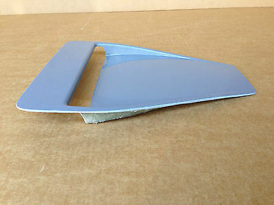

Interesting project. I assume the cutting you reference is edge profiling the shape for aesthetics. One thing you may want to consider is using the surface area to deflect and direct air towards the engine. A small NACA scoop would create ideal geometry to do this. NACA scoops leverage air flow over a shape and help capture and direct it where it is needed most. There are LOTS of places to buy preformed ones of various sizes, materials, and geometries (just Google "NACA Scoop". They even have some with articulating nozzels on the aft side to more precise exit control. Here is an example.
Anyway.... just a thought. Good luck with the project!

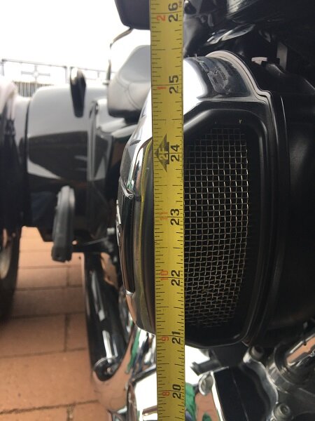

I have 2 concerns with your air deflectors. 1 is no air flow to your air filter.

I have 2 concers with your air deflectors. 1 is no air flow to your air filter.

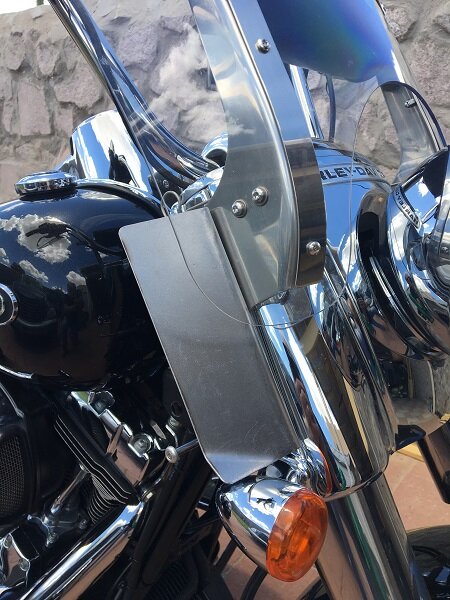

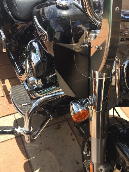

As to air flow to the air filter. I took that in to account when I made them. See Pictures:

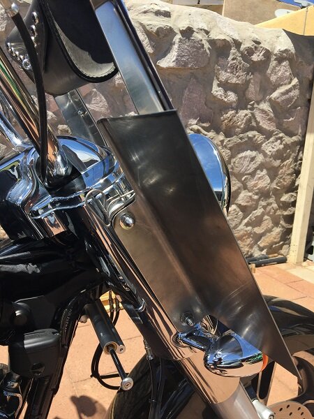

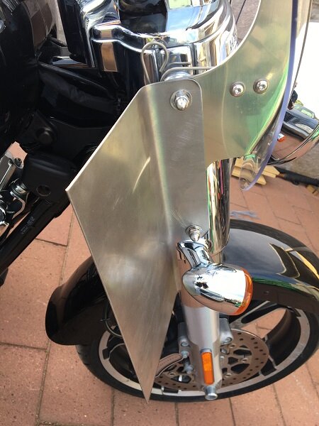

I did a test on the deflectors today and fount that by mounting them so that the deflectors are above the turn signals and not behind and extending below the lights as seen in first pics, the air flow to the engine was great, I could feel the air strongly on the bottom part of the gas tank and almost non on my chest and face. See new pictures:
I still have more to do on the deflectors and will post pictures as I make changes.

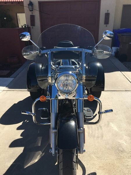

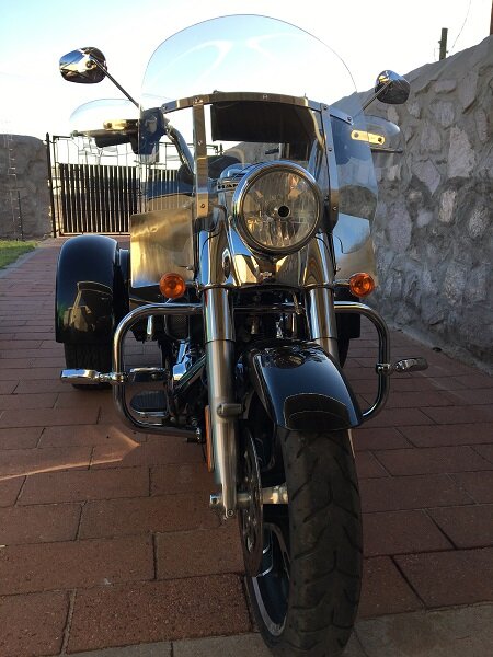

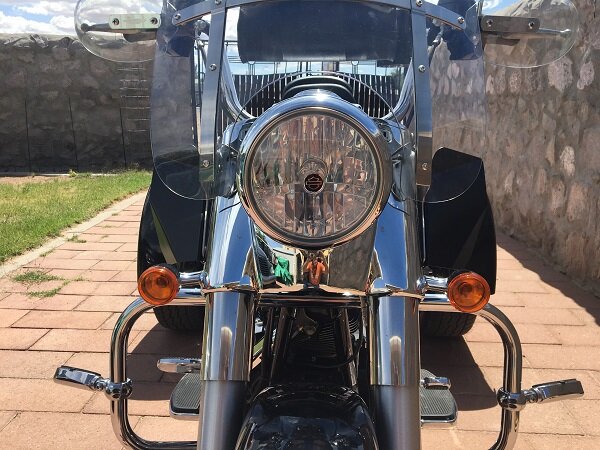

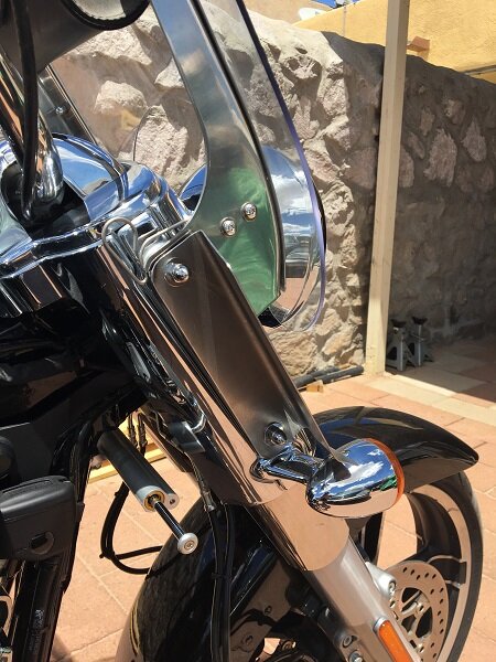

Finished the deflectors and they work well. I could have started with a 6"x 8" drilled the two holes and made a bend 2" from edge along the 8" length round the edges and my another bend at a angle at the bottom outer edge. See pictures:
