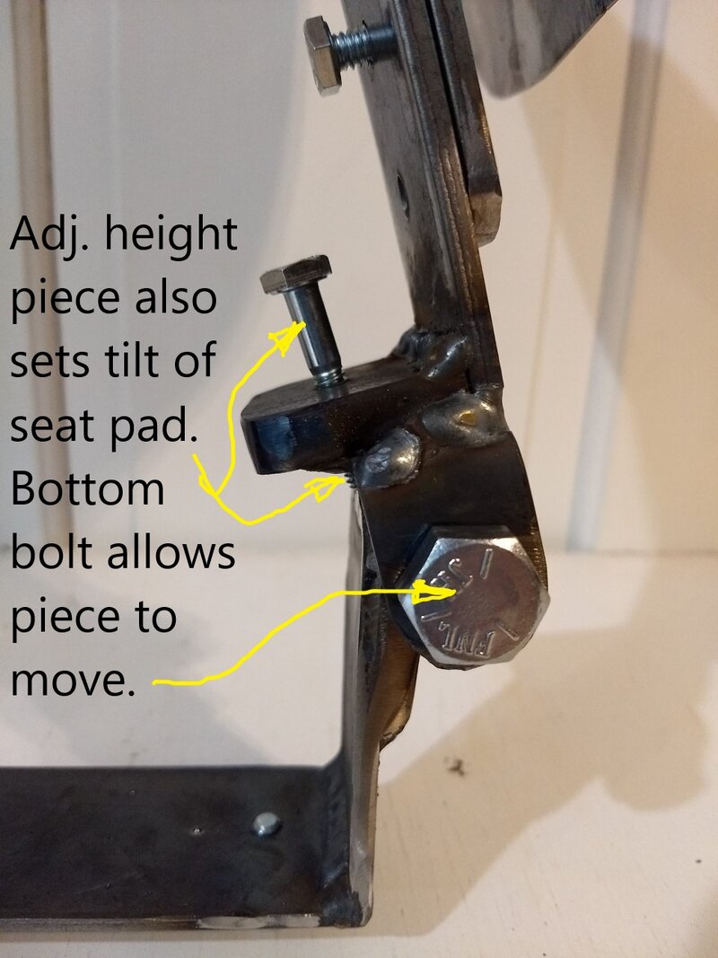

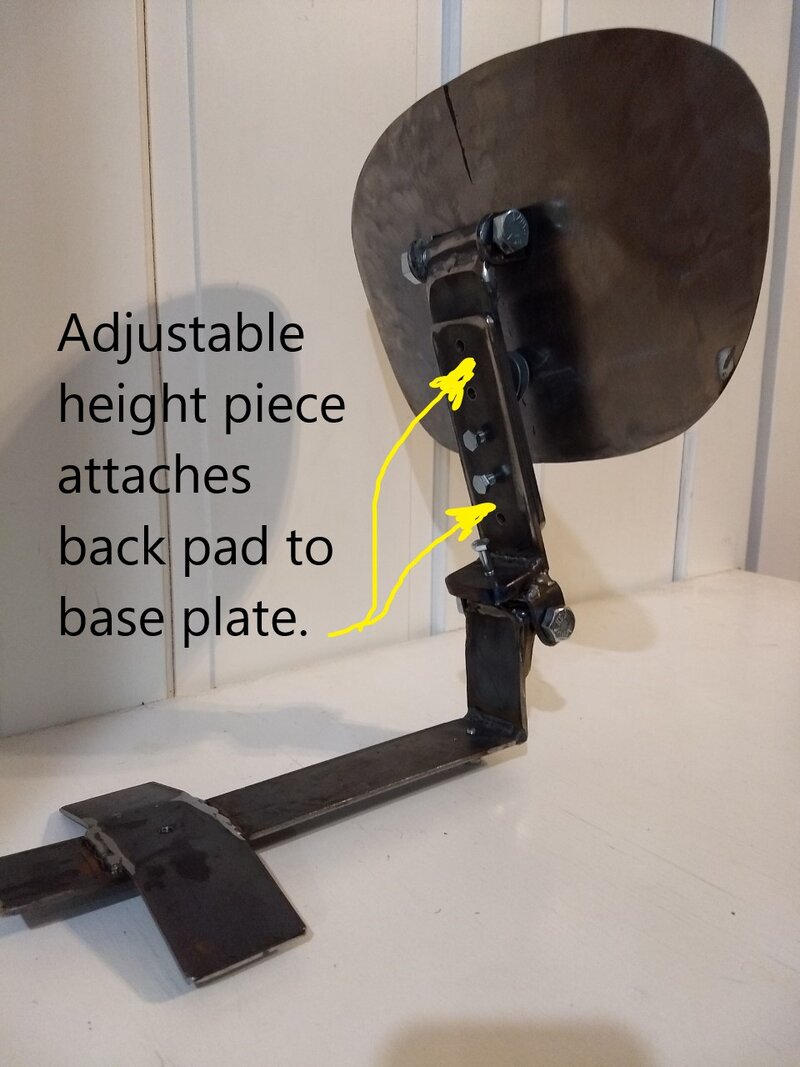

I knew that I now wanted more than just the basic non-adjustable (BR), I needed adjustments and flexibility to boot.
I could do at home,
with a welder, grinder, drill, tap/die set, spray paint and some other stuff to make the (BR).

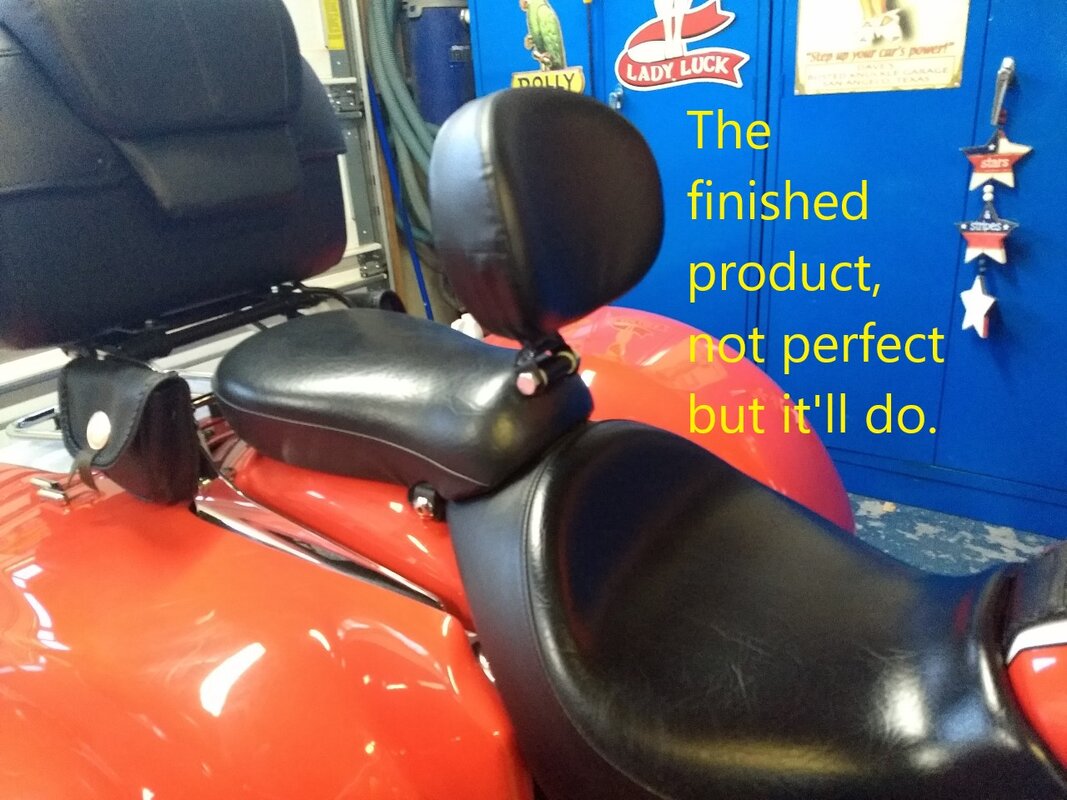

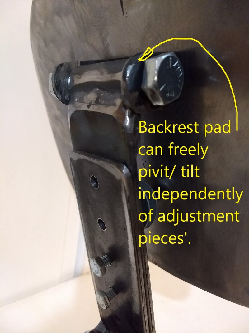

Pictures below, show both the raw metal construction (close-ups) and finished (BR) on the bike/trike.

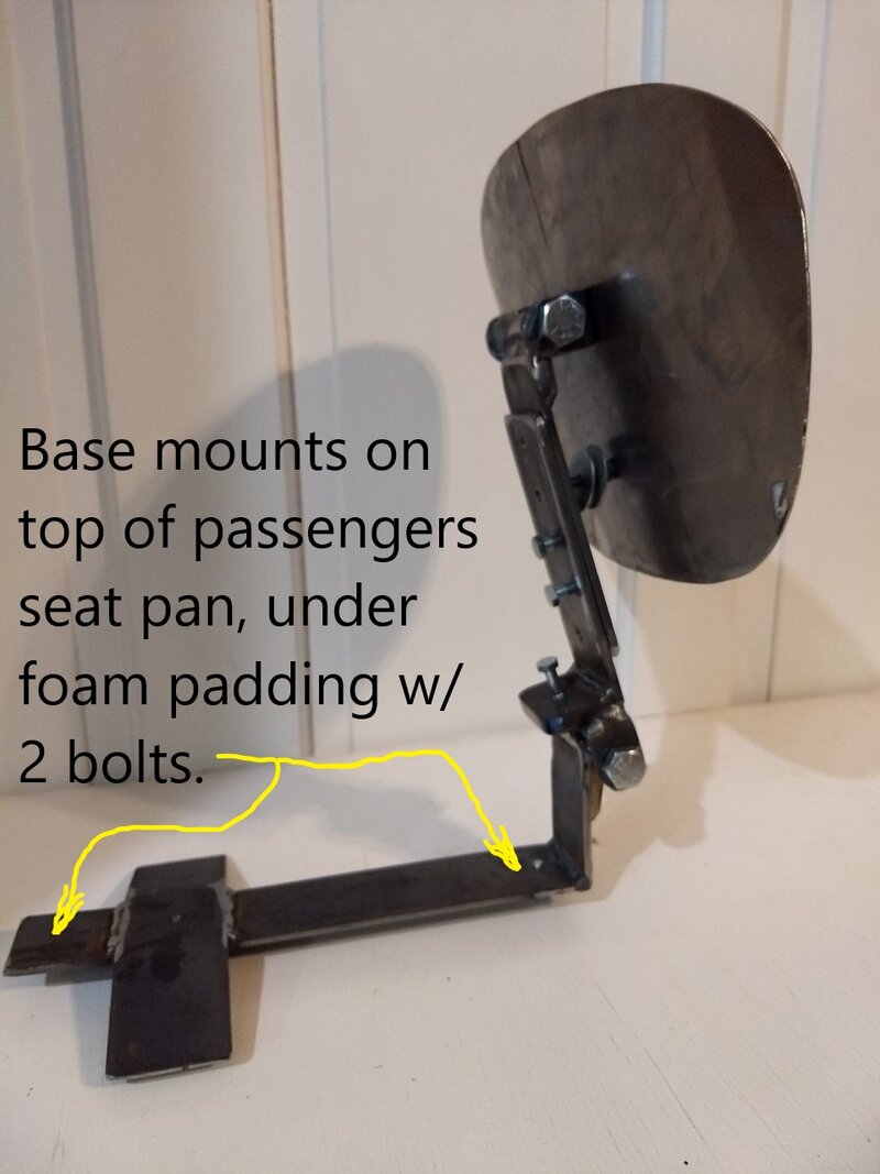

I did end up cutting an inch from the eyelet pivot point and welding the base piece that mounts to the passenger’s pillion pan to fit better.
I also cut 2 inches from the adjustable height piece(s) as initially in the lowest position it was way too high on my back.
The (BR) pad is an eBay item, little smaller than I wanted but beggars can’t be choosers.
So let me know what you think, good or bad, I got big shoulders.
