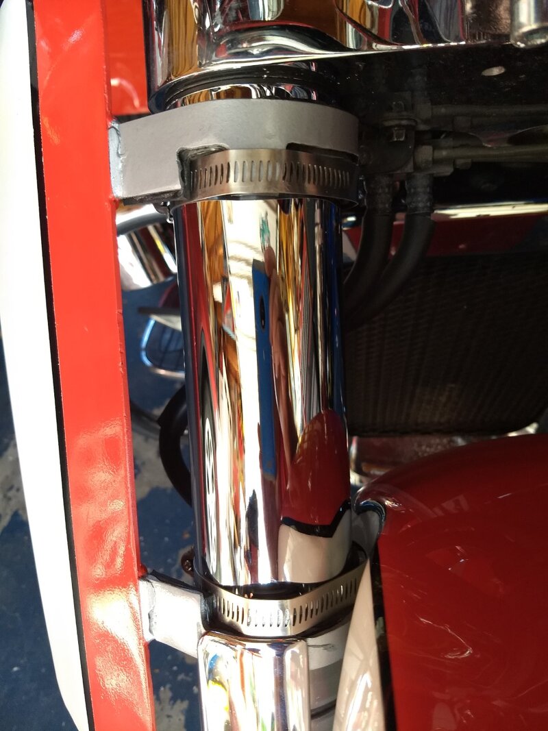

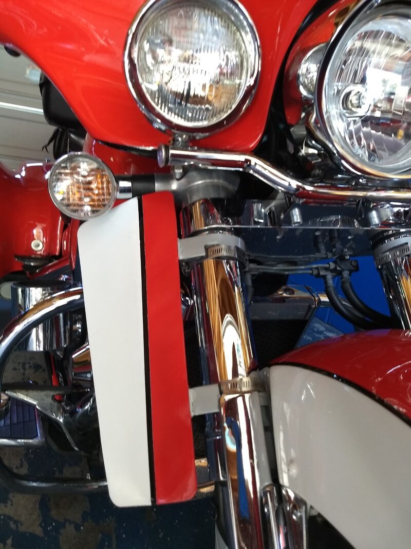

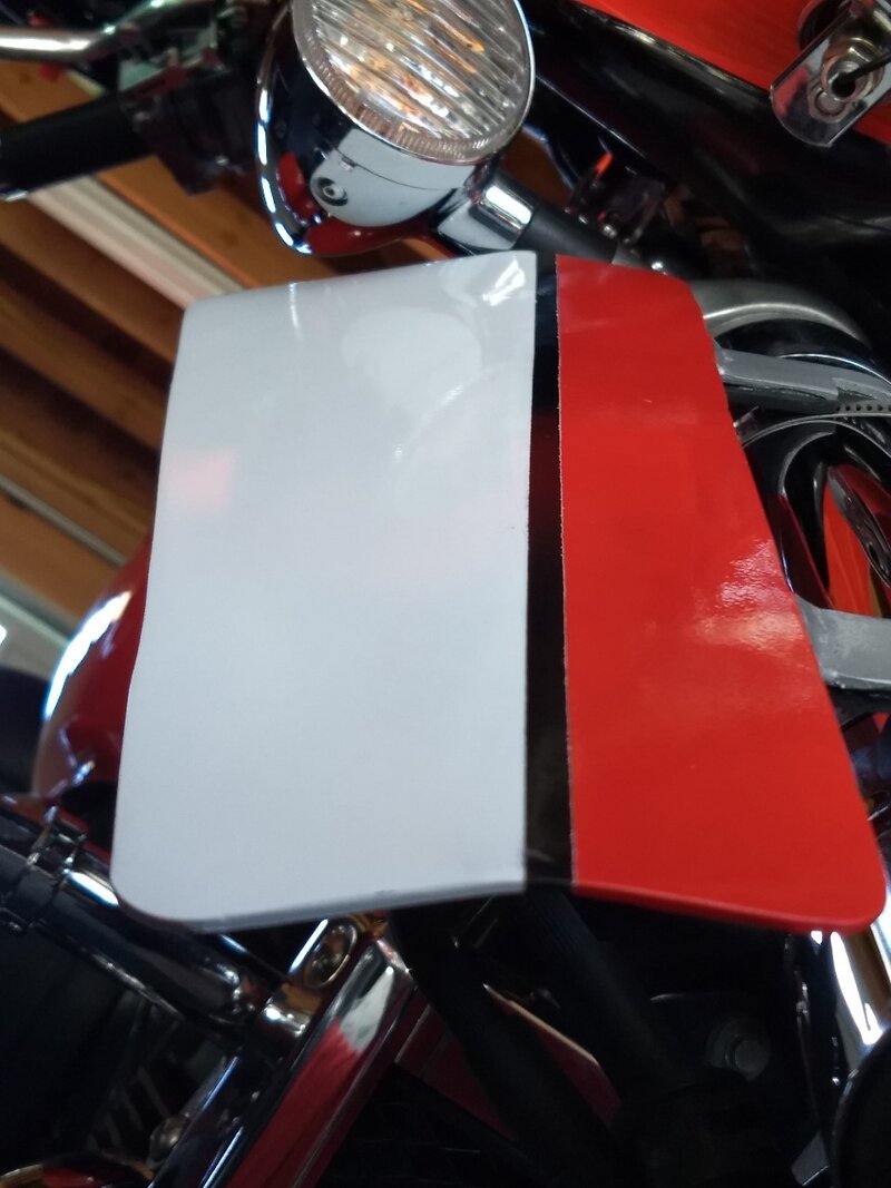

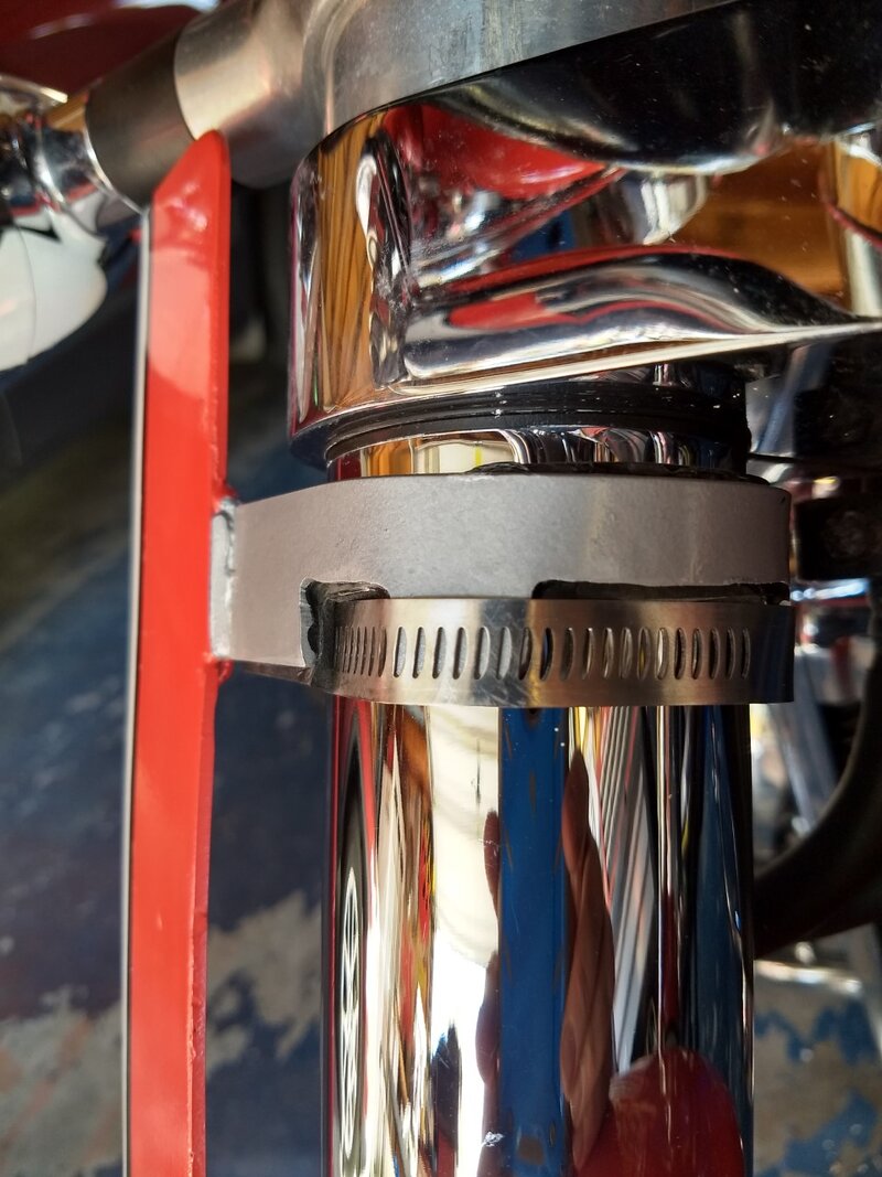

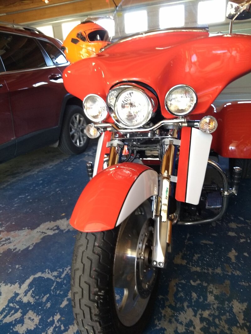

So wanting something more personalized to the trike I made a set from steel and painted them to match.
I used a scrap outside electrical panel door, to cutout not only the lower panels but also for the 3/4" brackets that go halfway around the forks.
I measured from my turn signals down to what I thought looked pretty good without getting to long for the lowers panels, 13" by 6" at top and 4" at bottom.
I did a simple bend about 1 1/2" out from the forks (I put the black divider line in the paint there too).
I made the bracket (straps) 6" by 3/4" (bending about 4" around a 3" pipe) so that they looked similar to the letter J.
Next I cut two cutouts roughly 3/8" to 1/2" deep, at 1/2" intervals from the curved end of the bracket, to allow for the pipe clamps to be able to get a bite in the bracket and the front forks when installing.
I also installed some 1/8" thick rubber with glue to the underside of the brackets where they will contact the forks.
The next step was first to mock up the brackets and the lowers plates on the trike to mark position and weld areas.
After the two lowers were all welded up I checked fit again and prepped them for paint.
I know I wanted to follow the paint scheme that was already on the trike so I laid out what you see below. (rattle can job).
Oh, I took her out for a ride and wind buffeting is almost nonexistent now.
My cost comes down to my time / scrap metal / welding and cutting / scrap rubber / and 4 3" pipe clamps about $8.00 dollars.
Now some pictures (colors are off from taking pictures in garage) but here goes: Ta Da

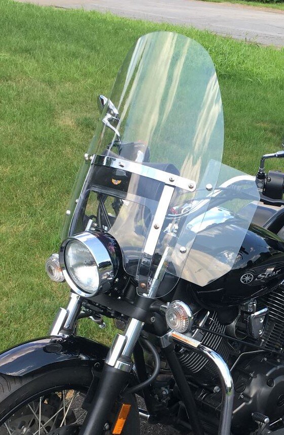

You guys who know how to weld and fabricate with metals are my envy. But, I discovered I could butcher plastic, so I too gave it a whirl. :) Between my forks design and windshield setup, there weren't a lot of mounting places, but they did redirect a lot of turbulent air.
Great job on both for resolving your buffeting issues. For the OP though, don't know if you are getting much buffeting now but if you are still getting some coming over the top of the shield, you might be able to find a recurved shield to replace the original. It will shoot air up another two inches and it sounds like that might help in your case. I have an adjustable shield but a recurve allowed me to get a height, that full up, I look thru and full down I see over. The recurve made it all come together for me. But in your case, getting two more inches and still being able to look over might be near [FONT=DDG_ProximaNova]nirvana.[/FONT]:Shrug:
