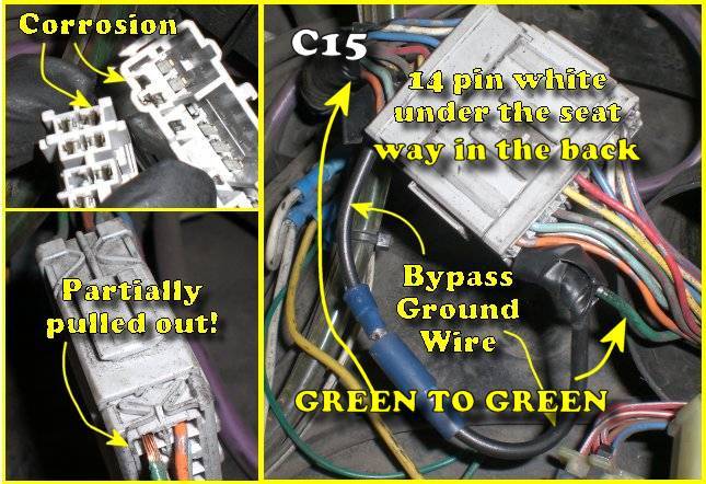

Broken ground wire to the left side (the side not working)
Located under the seat
there is one wire that acts as a ground for the ENTIRE rear end lights.
That single wire splits off somewhere in the harness to the right and left.
I would bet money that the wire going to the side that is acting crazy is broken.
The wire starts in the grey connector under the seat to the rear on the right side next to the relay box.
If you disconnect that connector you will more than likely see green corrosion on a pin in the lower right or left hand corner
let me get you a link
Here is a link where I had a similar problem
http://www.triketalk.com/forum/threa...RESOLVED-FIXED
This ground wire is the wire that splits off in 2 directions. In your case I believe that the wire going to the bad side has broken.
