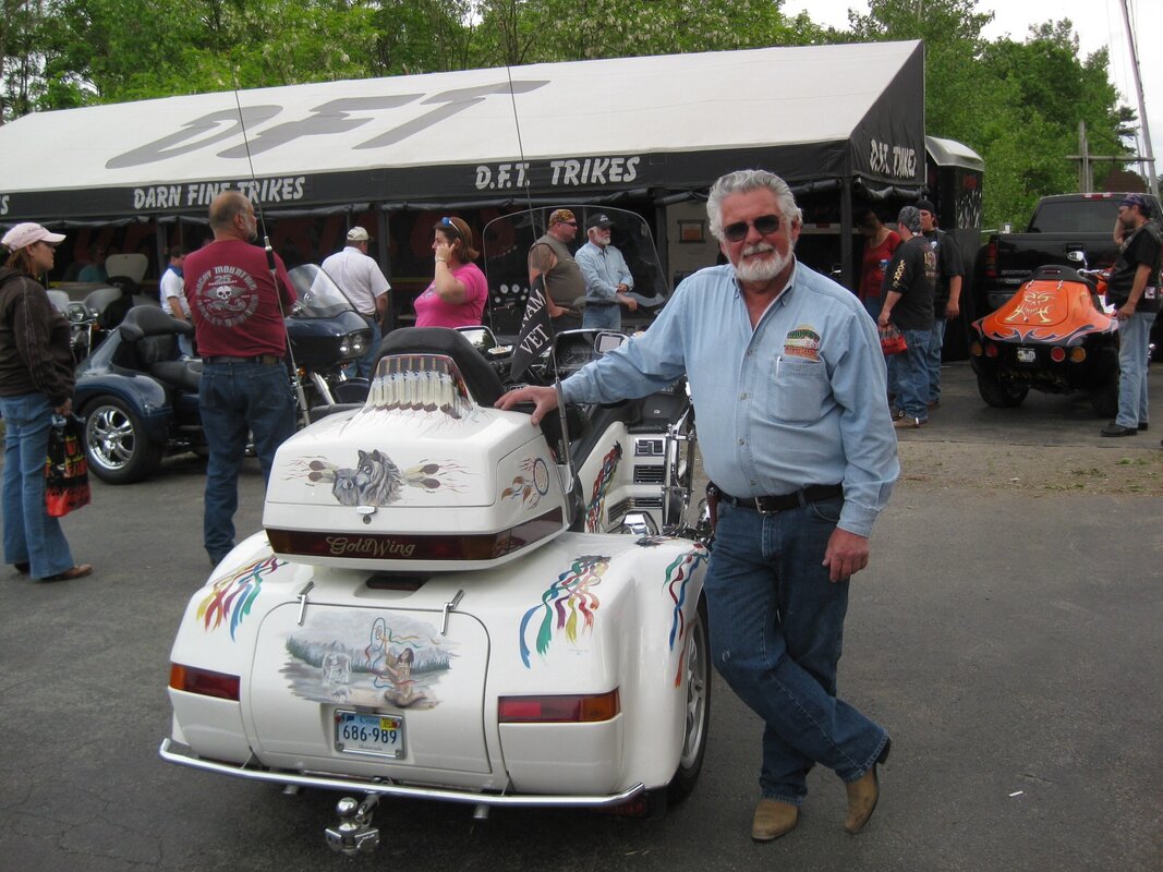

The trike I own belonged to Rosa the CoOwner of DFT ( Leon's wife )
Leon checking out my trike.
