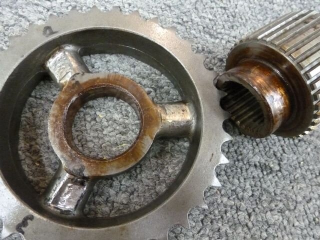

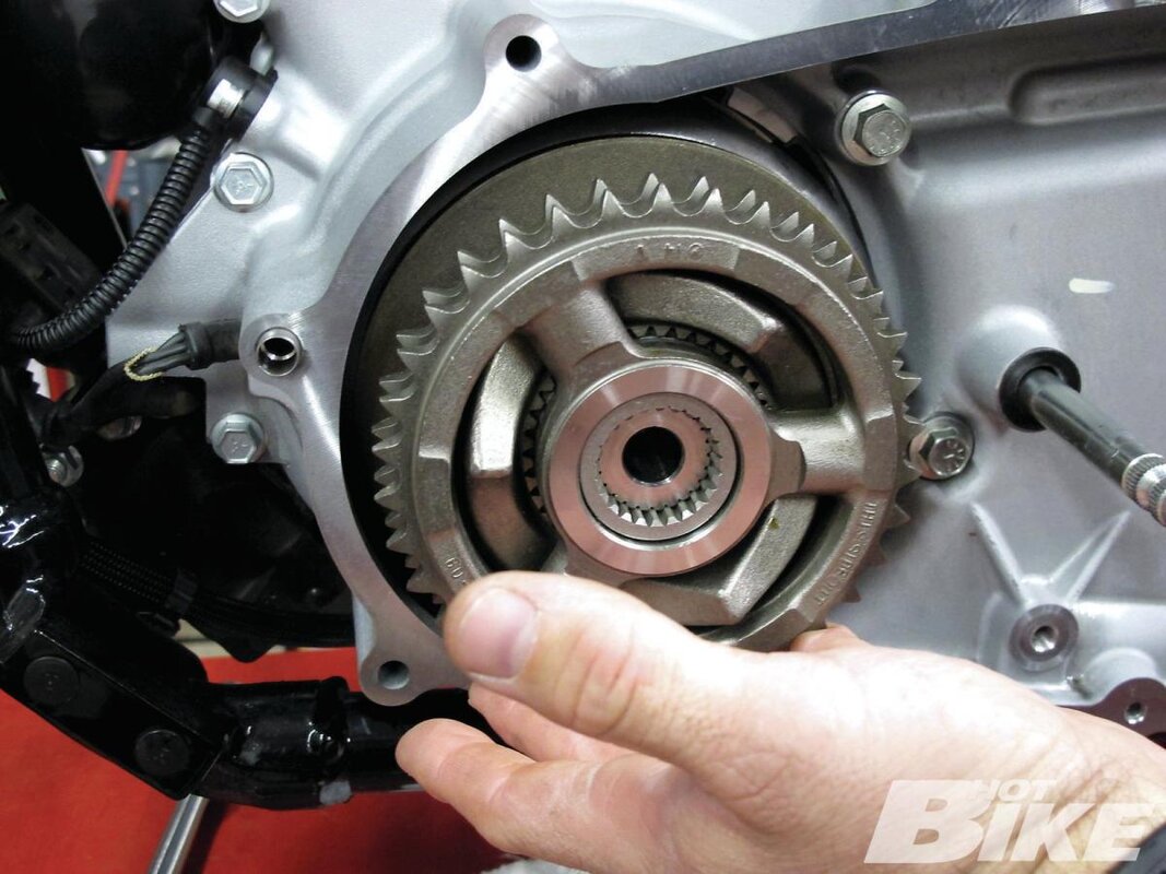

Possibly the compensator on the end of the crank shaft. It's kind of like an all metal cush drive for the engine.
Here is a pic of an SE upgraded compensator. Another helpful link > http://gmrperformance.com/products/compensaver/

Ding Ding Ding Ding.... We have a winner, its the compensator. Some noise like that is normal, however the compensator on the 2009 - 2013 Triglide is a weak link, its not a matter of if it will go bad, it's a matter of when. Normally when the compensator is going bad it will clunk when you shut the engine down after the primary has warmed up, the clunk will continue to get worse.
The failure is caused by lack of lubrication, the design Harley is using is not being lubricated properly for all the stress it is under. They have made many changes in the design trying solve the problem, the redesign for 2014 seems to be lasting a little longer.

It is possible to still be the compensator, a little amount of noise at slower speeds is normal. At freeway speeds it shouldn't be making noise. The lack of lubrication causes fretting and wear to begin very quickly. The only thing which helps the compensator last a little longer is running Formula + oil in the primary, it seems to stand up to the pressure a little better than some of the thinner oils. Like I said, its not a matter of if, its a matter of when the compensator will need replaced.

Correct .... newer 103s use a compensator more similar to the SE one I posted a picture of. :pepper:
Bob :Dorag:
The compensator is like a shock absorber that rotates. Its function is to take some of the jerking out of the primary chain as it drives the transmission through the clutch. What you describe as happening is what the compensator does, but it sounds from what you are saying that maybe it is getting weak. When there is steady pressure then no you should not hear any extra sound like you are saying that you do not hear. I would not worry much about it for now unless your warrantee is getting close to running out. As the compensator wears what will start to happen is there can be a POP through the exhaust either when you start the motor or when you shit it down. That usually means the compensator has worn to the point that it needs replacement. The noise that you are hearing now IMO won't hurt anything it will just wear more then will have to be replaced.
My compensator has been replaced multiple times. Usually lasts 25k. Went once at 11k. Even the newer one with oil slinger only lasted this same short span.
HD mechanic has shown me the seperate parts multiple times. Complete junk. His words also.

The sad thing is Harley had a good compensator design on the 99 - 06 twin cams. The compensator on my 06 Ultra has close to 40,000 miles on it, most of them being hammered with a pretty stout 95" build. The same compensator is now being pounded on by the 120" engine I built a couple years ago, its still going strong and makes not a sound.
I put on the new SE comp and was pissed the thing was fretting from day one. When I opened it up I was shocked the lack of lubrication the unit had which was causing the fretting..
Take a chance and wait for the thing to fail or keep putting more good money into bad..
