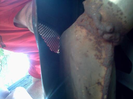

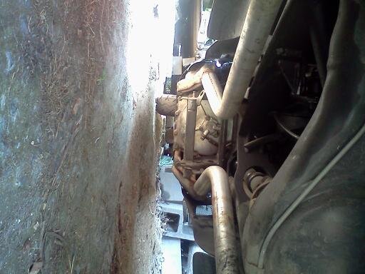

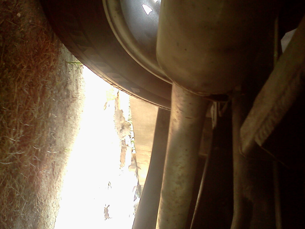

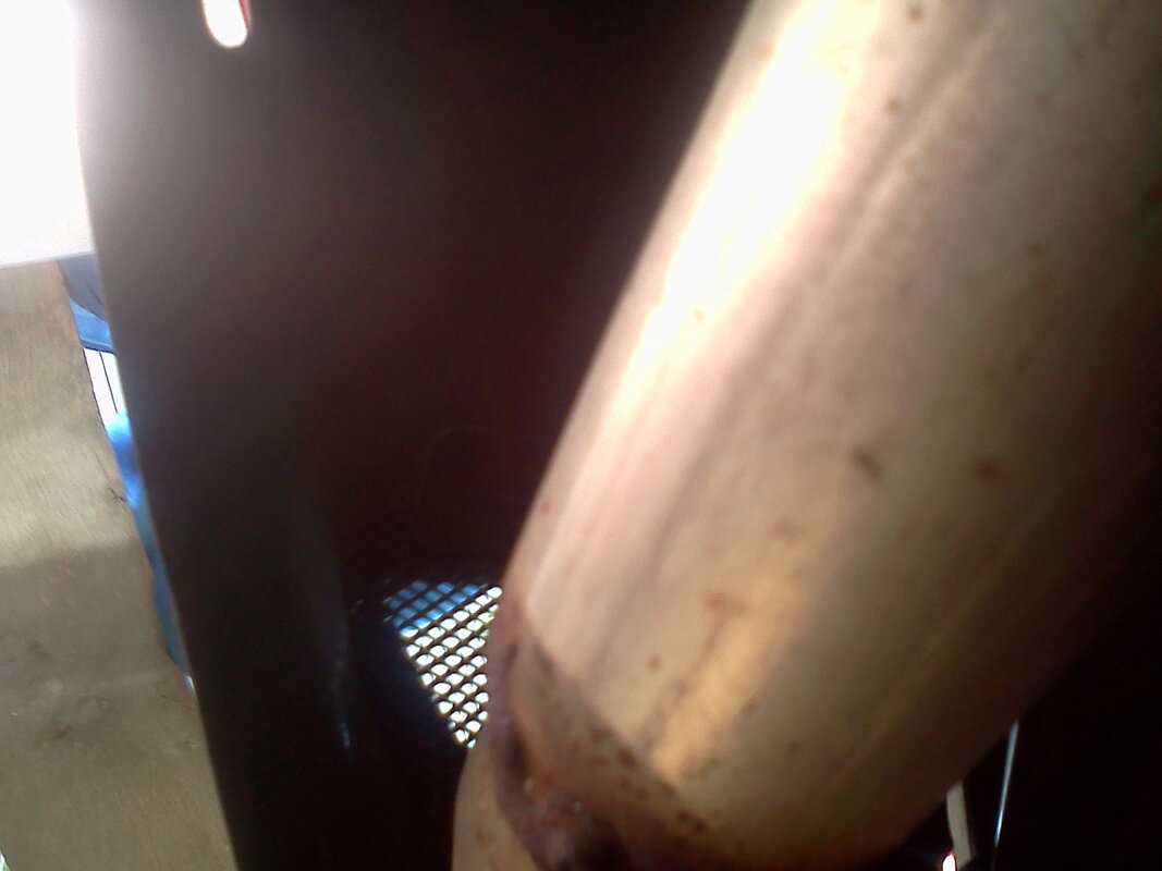

On mine the resonator has been removed.Looks like they welded the pipe over the nipples on the head pipes and went to the mufflers.I'll take a few picks and post later.Shouldn't be a problem for a decent muffler shop.
