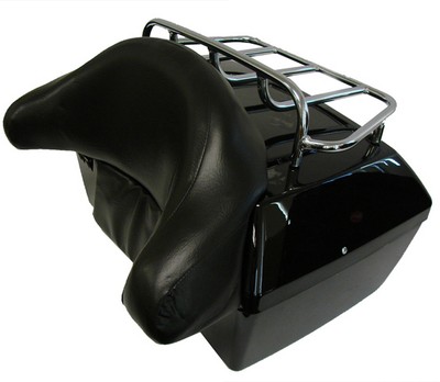

Ive BOUGHT 4 OF THESE, BEAT IT FOR THE MONEY AND I WILL BUY ONE MORE.

Details about Motorcycle Tour Trunk w/Rack For Harley Sportster Softail Dyna Electra Road King

HEY ITS BEHIND ME, I CANT SEE IT, YA GET USED TO IT, AND FOR THE MONEY IM IN COMPARED TO OVERPRICED GLASS STUFF
