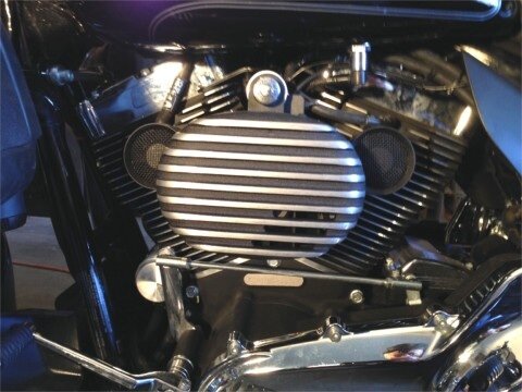

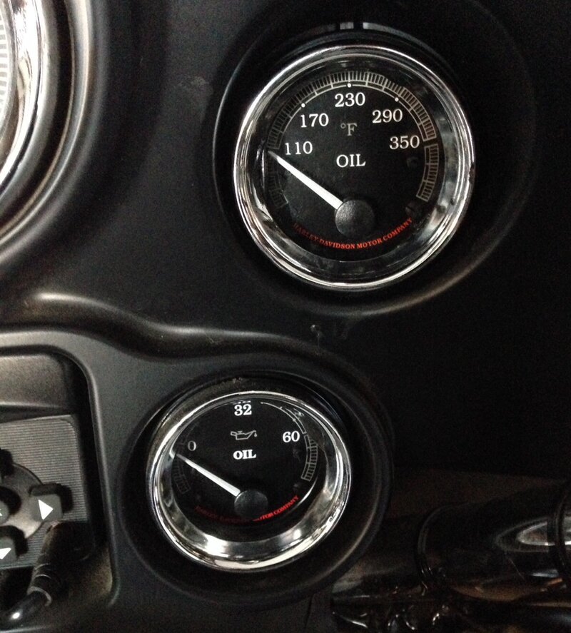

I was really mixed on this subject so Friday I installed a set of Wards FSC fans (with a mini-Beast II), Zagg 10 row, fan assist oil cooler AND a HD temp gauge. Run Amsoil syn oil so hope'n that'll do the trick.
Ohhhhh, also tossed the useless 'air temp' gauge. Moved the volt gauge into its spot and installed the 'oil temp' gauge above the 'oil pressure' gauge.

Guess thats just one of the reasons I went with Jason Ward and his FCS fans. I looked at functionality as well as the cosmetic aspect.. Most others were big and flashy which I did not want.
When talking to Jason he totally understood. AND like I've previously indicated I have a mini-Beast II horn. Jason fixed me up with a special MB horn mount and the FCS fans with black screens.

Guess thats just one of the reasons I went with Jason Ward and his FCS fans. I looked a functionality as well as the cosmetic aspect.. Most others were big and flashy which I did not want.

What ya can't see is the Zagg 751-FP2400 fan assisted oil cooler, your lifts in the rear and ClutchWiz.
This is what did to the inner fairing.
