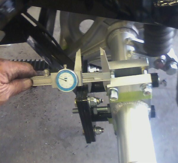

Start with a new belt from HD. Drop the bucks and don't be cheap I have never had great luck with aftermarket belts, Check it at least seasonally for proper tightness and axle alignment, it isint all that hard to do.
d-8-usingadialcalipertoadjustalighnmentonaxleanddrivepulleys_zpsfd2f8067 (600 x 548) (2).jpg d-7-checkingforbeltplay-oneandahalfinchplay_zps58475571.jpg

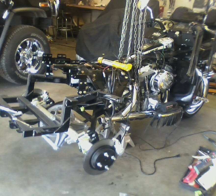

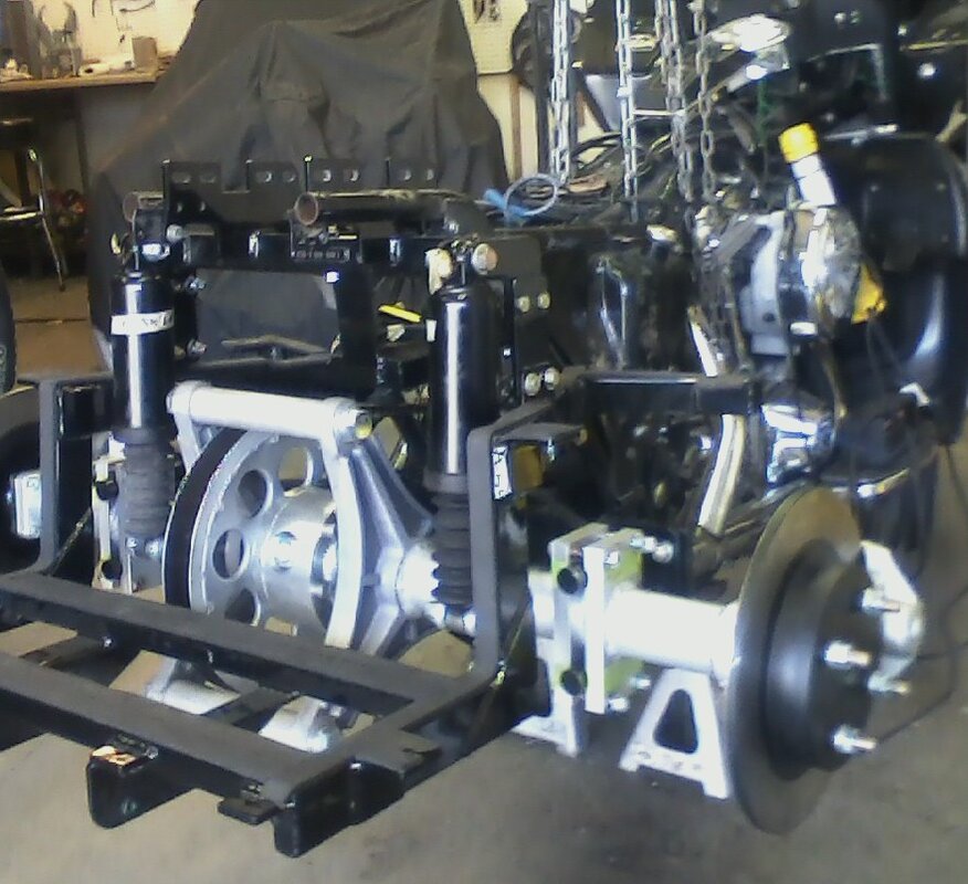

To see pictures of my conversion google-- pcombe photobucket/library and get on with the task at hand. Click a picture and it gives an explanation of what I am doing.
