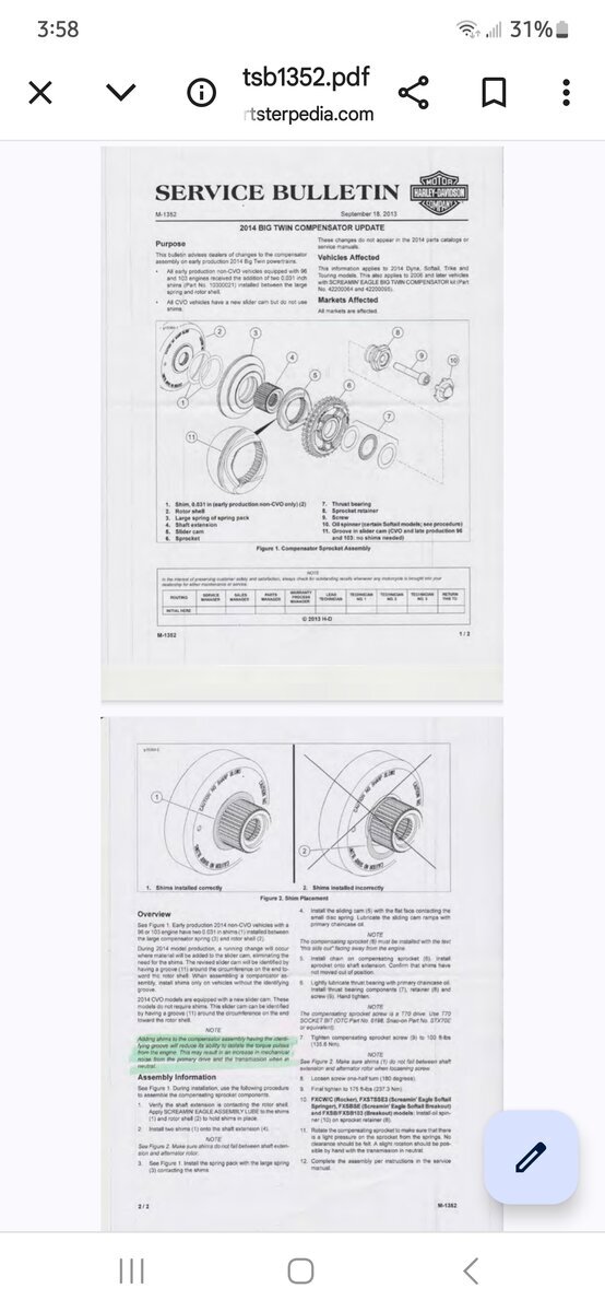

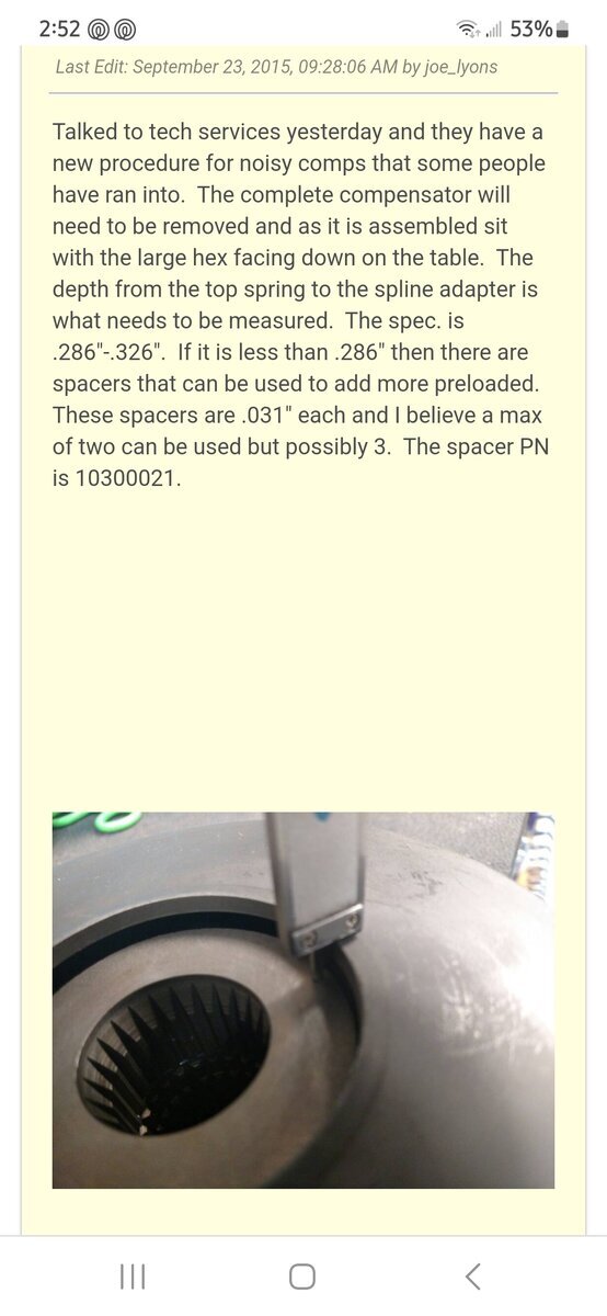

Before I went with an expensive compensator I wanted to check everything out first. Having the second compensator go so fast I felt that must be something else wrong. There was. It took me awhile to find it but I finally found it. I checked the spring height of the spring pack. Supposed to be .286 to .326".
I measured it in three places and got from .248 to .250. Harley sells shims to put behind the spring pack against the rotor to beef up the spring pack. When I added two shims of .031" each, it brought the height of the spring pack up to .308". Started the bike up and it sounded great. No compensator noise at all, whatsoever. What I do hear now is a little chain slap coming from the primary. I haven't ridden it yet so I don't know if the self adjuster will adjust that out or not. If anyone has any experience with the adjuster please chime in it.
Before I went with an expensive compensator I wanted to check everything out first. Having the second compensator go so fast I felt that must be something else wrong. There was. It took me awhile to find it but I finally found it. I checked the spring height of the spring pack. Supposed to be .286 to .326". I measured it in three places and got from .248 to .250. Harley sells shims to put behind the spring pack against the rotor to beef up the spring pack. When I added two shims of .031" each, it brought the height of the spring pack up to .308". Started the bike up and it sounded great. No compensator noise at all, whatsoever. What I do hear now is a little chain slap coming from the primary. I haven't ridden it yet so I don't know if the self adjuster will adjust that out or not. If anyone has any experience with the adjuster please chime in it.
Dale, I’m glad those shims did the job for you. I’ve got an occasional compensator “rattle” at idle when warm. I believe it’s time for exploratory surgery to check things out. Do you have the part number for the shims? Also, did you reuse the primary gasket and did you have to pull the clutch basket?
Did not have to pull a clutch hub to work on the compensator. Only the chain adjuster. I did not reuse the primary gasket this time but I have in the past without a problem.
Number one on the diagram shows the location of The shims
