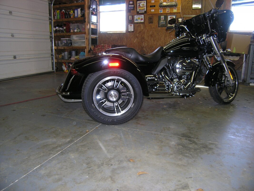

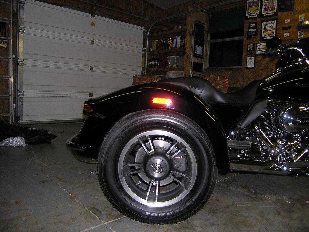

I guess I'm dense, but I didn't want to just put jack stands up under the rear fork frame. My H-D trike repair manual is specific about jack points, but not how to jack up the REAR end. And I'm not alone ~ when I searched under rear+jack+point, several other members, who work in their driveways like me, also were hesitant to just put them anywhere. In the end, there were damn few spaces they would fit up there.
I have a 2014 "Premium Comfort Lift Kit" instruction sheet. Although it tells you to "raise rear of trike until rear tire are off the ground" I guess I needed different words like "rear fork" (which is HD-speak) Rear Swingarm (Lehman-speak) or "K" frame, which is self-explanatory. Also, the "Z-pipe" (HD called it the "connector pipe" P/N 65600103) didn't come into play in Freewheeler install.
I'm familiar with trike belt adjustments from my 2009 Lehman Raider. I knew, months ago, that the FLRT belt felt too tight, but I didn't know exactly how tight it was. Since I had both rear wheels off and most of the pinch bolts out anyway, I loosened the belt, from 3/16" to 3/8".
I'm no speed demon. Cleaning all the holes and threaded bolts, and coating them all with Loctite took almost a 1/2 hour. The whole project took the best part of a day. But like a turtle, slow and steady, I eventually get it done. Off the jack stands, I adjusted the headlight, and I'm a happy Triketalk member
Does it ride smoother? I don't care ~ I installed the lift kit because I didn't want to scrap my mufflers on the curb (again :gah:)
