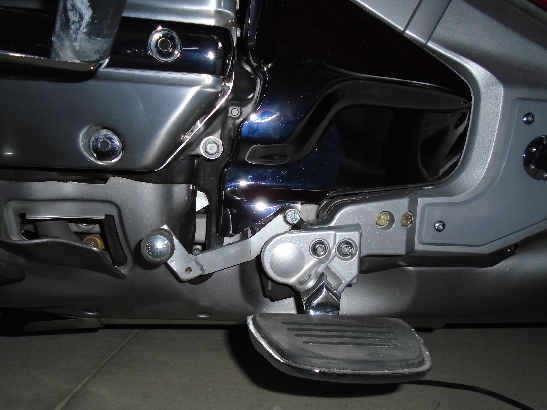

I have a 2012 with the Comfort controls. They were on the trike when I bought it last year.
They lowered the foot position 1", and moved them forward 3".
I further lowered the foot position 3\4" with the Kuryakyn Mini Boards.
There were 2 problems I had to deal with. When the Toe Warmer doors were open (I don't think your 2007 would have them), I had trouble shifting because my boot would hit the top of door when I would try to downshift (the PO told me he quit using the warmers)
The second problem was, even though I lowered the foot position 3/4"in relation to the shifter with the Kury Mini Boards, I found the shifter to be too low!

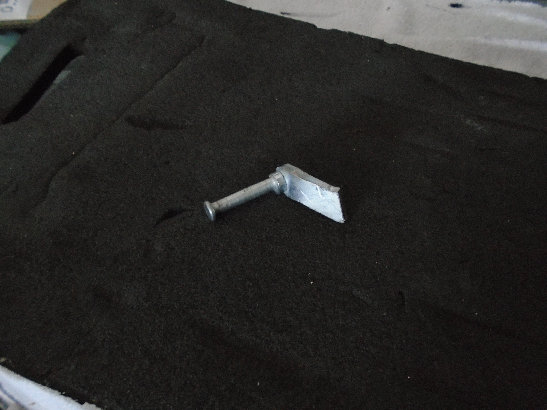

What I did was cut the shifter and modified it to shorten it and raise it to allow me to shift without the interference of the door, and it allowed me to position my toe under the shifter without having to reach down.
The last pictures shows the part of the shifter I cut off.
I used a piece of 3/4" X 1\4" flat bar to make the new shifter extension. It had to be twisted to get it to come out straight.
I then drilled and tapped the extension so that I could use a 1\4" carriage bolt for the peg. I used a 1\4" nut to lock it into place.
I initially bolted the extension into place so that I could adjust it the way I wanted it.
Once I was happy with it, I welded it together and removed the bolt.
I very happy with the results.
As far as the Comfort Controls go, I really like them, but if I would have had to pay for them, I don't think I would have purchased them (very expensive, especially in Canada).
I added the Mini Boards, and I love them. I would highly recommend them as they are not too expensive!

I went with the kuryakyn floor boards and heel toe shifter, these work great for me, I don't even use the highway pegs anymore. I am 6' and size 10 boot so it may be different for others.
