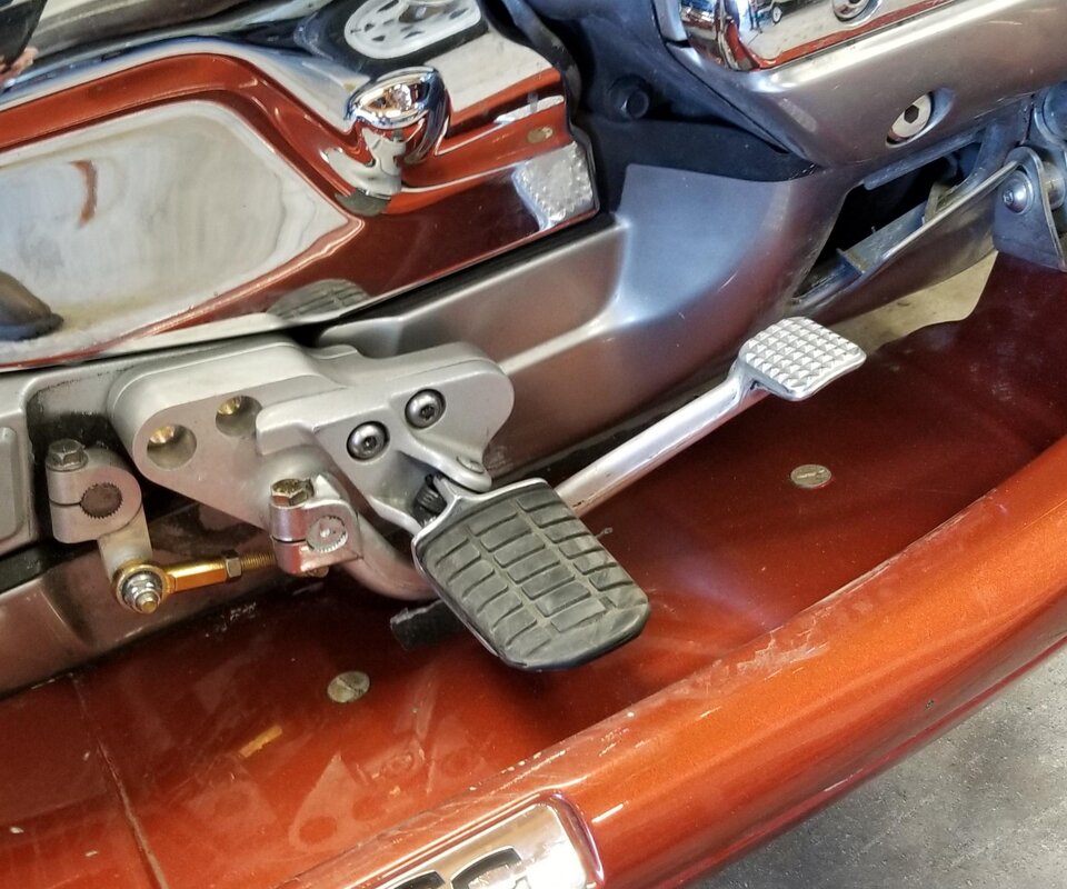

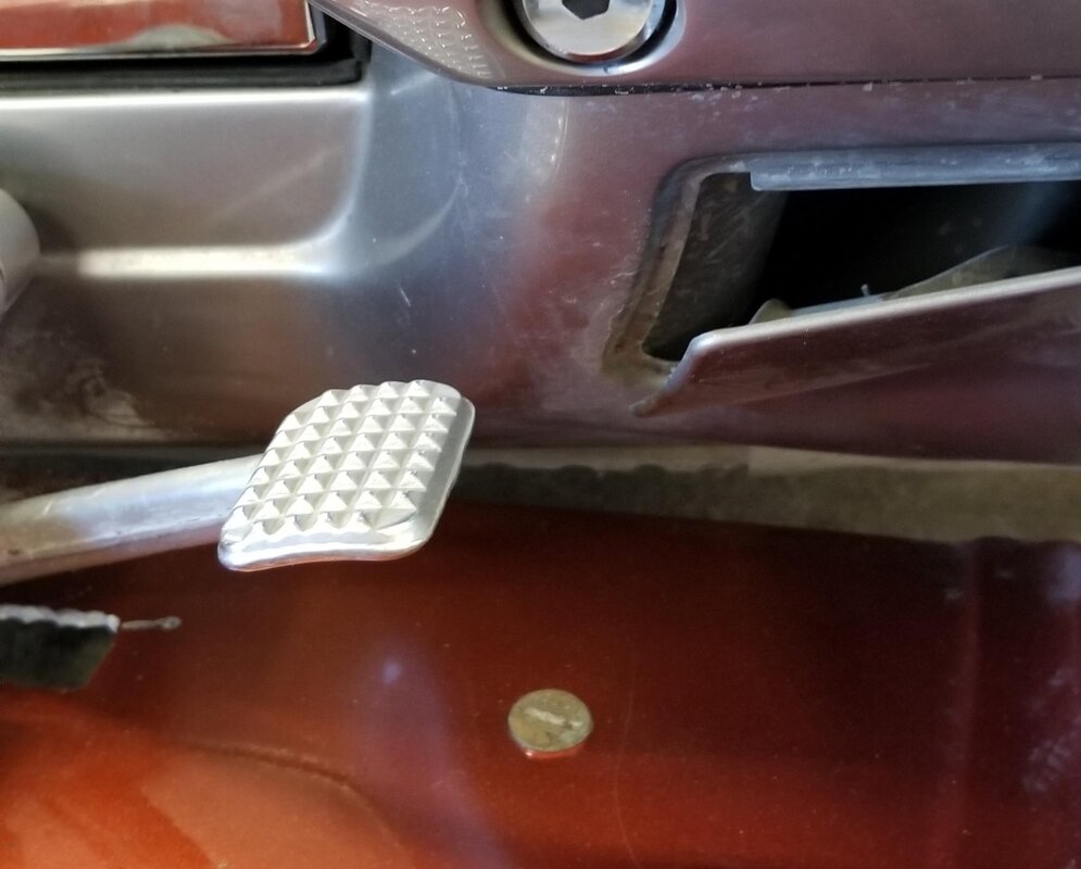

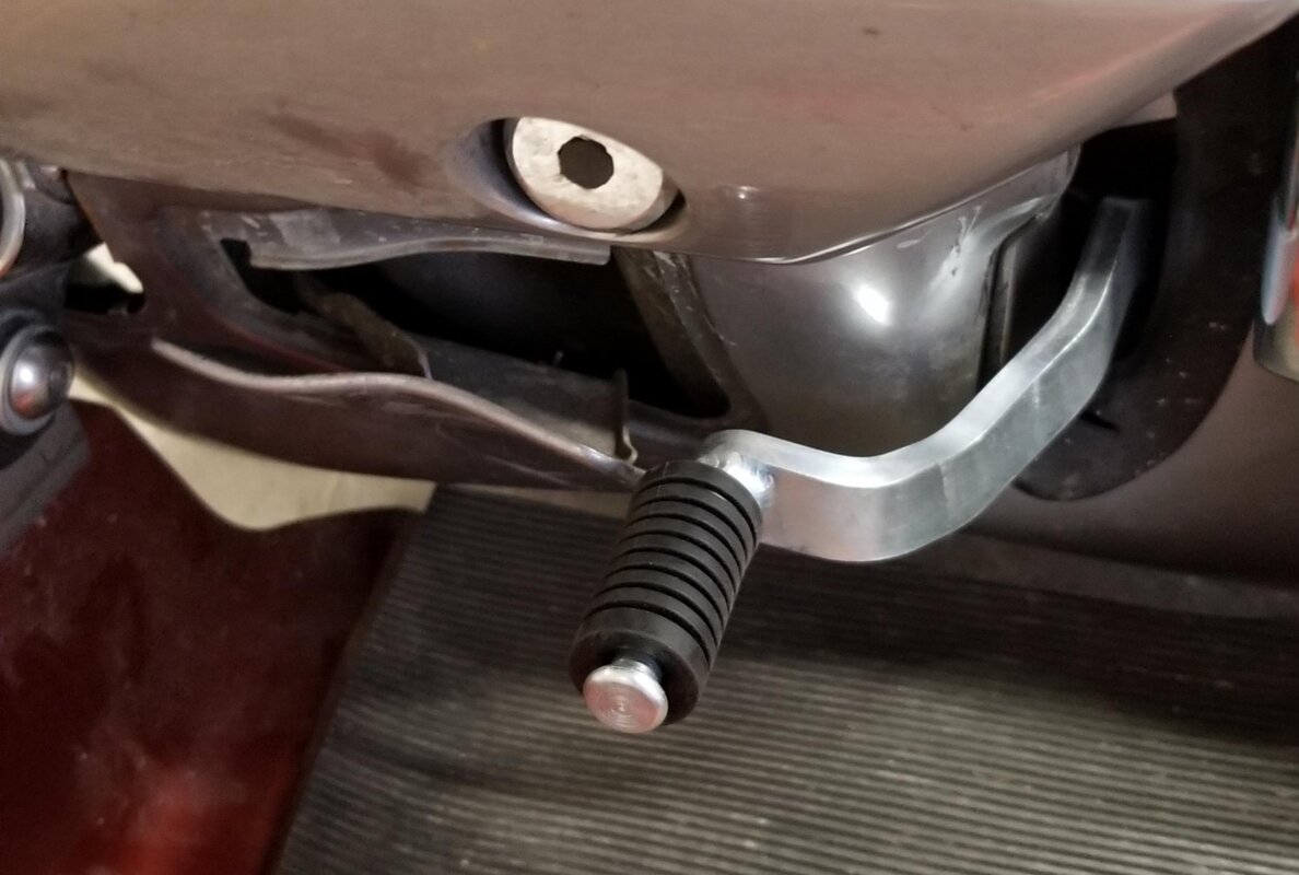

Plenty of clearance from foot warmer door

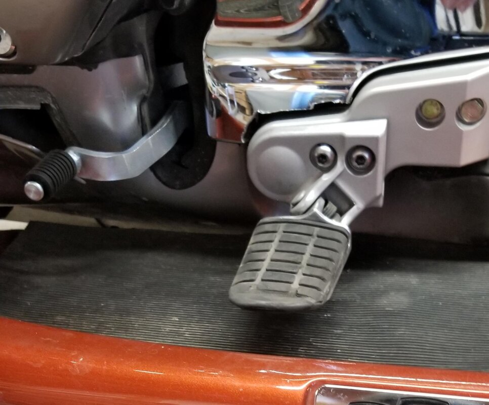

Shifter side clearance. You can see it's close but doesnt touch. I just have to mak sure not to place my foot all the way inwards. Pretty easy to manage.

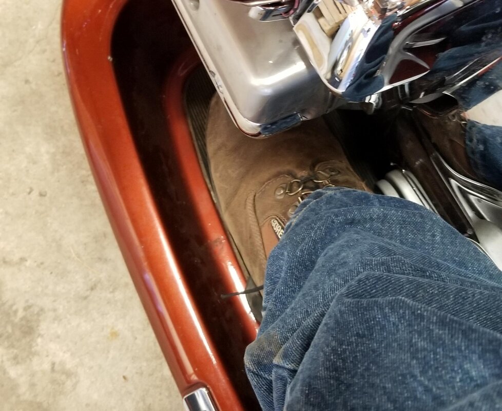

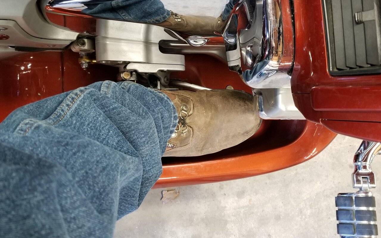

You can see my size 12 boots still fit inside the floorboards to use the brake and shifter lever. Brake side is close but shifter side has plenty of room.

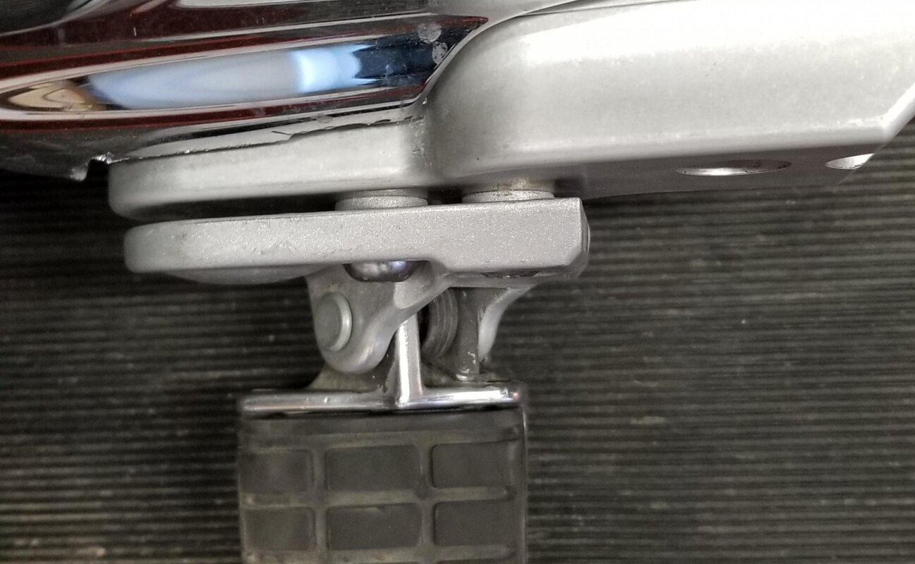

Here you can see the gap between the OEM mount and new mount. For me not a big deal. I have seen where at least 1 guy carefully grinded the bosses off the back side, I would be worried about accidentally taken too much material off.If I end up going without the pegs then it wont be an issue at all.
