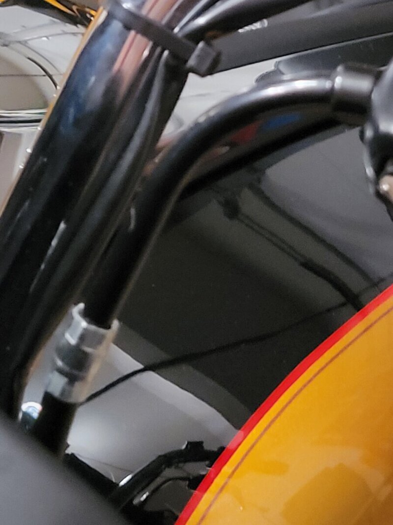

The metal ring you are seeing is just the transition from the metal elbow coming out of the clutch housing to the flexible cable portion.
