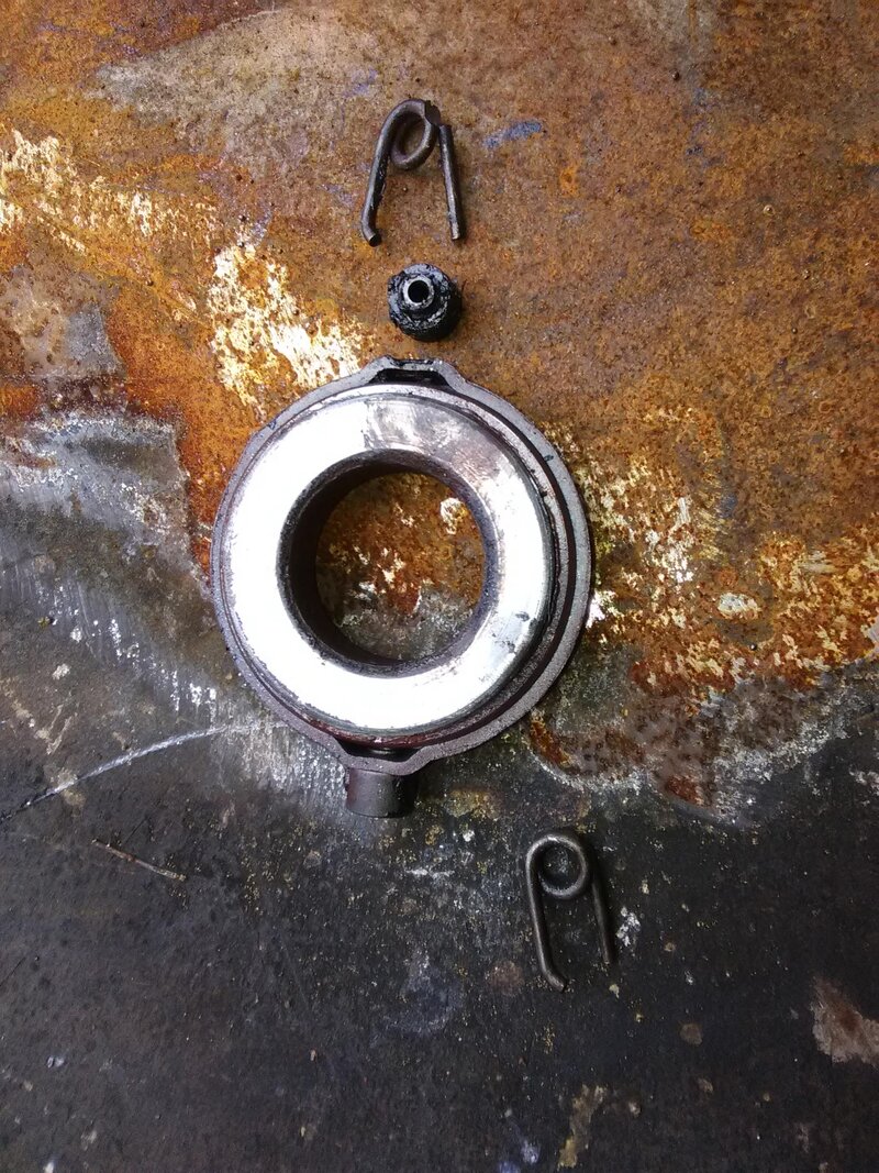

Yesterday the Ol'Lady and I were out on a ride about 100 miles away from home.
We seen a BBQ place and decided to stop for lunch
At the bottom of the off ramp I pushed in the clutch pedal and felt the clutch snap
I have not tore it apart yet but I think it may be the throw out bearing
Anyway I was able to get it into 2nd gear and slowly get to a parking lot

I was right it was the throw out bearing
Also see the spring is worn
This same thing happened to me about 5 years ago but it was the tab on the other side of the bearing
I will be ordering a complete new kit today
WOW! Pretty darned good diagnosis for just "feeling" the clutch snap. Hope the repair's as easy as the diagnosis was.
PC
Put a new clutch and bearing in yesterday
Cleaned and painted while it was apart.
It ready to go now.
