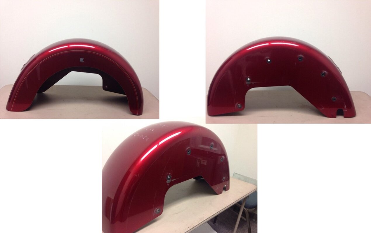

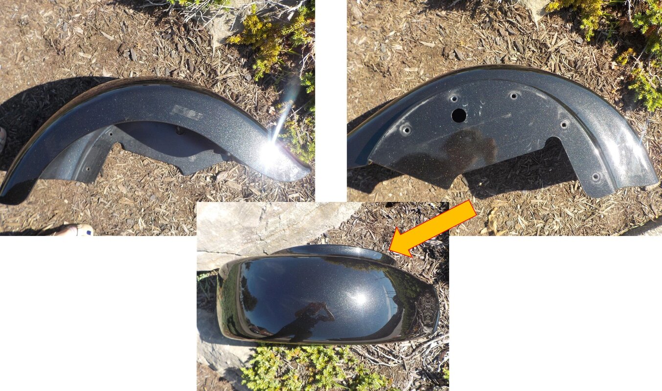

The main difference between Tri-glide and Freewheeler fenders mounting is one is flat to the body (the Tri-glide) and one has a filet between the fender and the body. See below.
The Tri-glide is going to have that filet space taken up by the actual trunk/box section width. The Freewheeler uses the fillet to extend the body our to the fender.

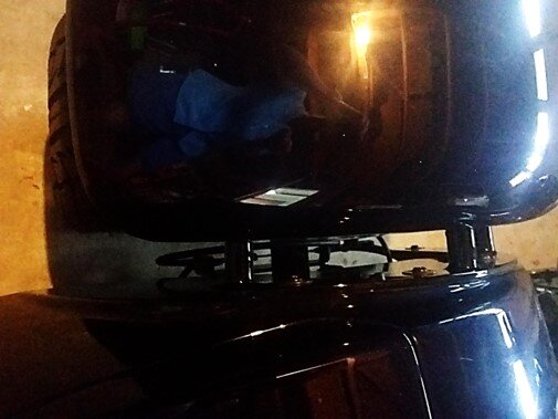

You could make a frame that attaches to the body and then extends out to center up the Tri-glide fender on the wheel.... Haute Pursuit (Blake) in this forum did something similar to mount his fenders. Here is a Picture:
