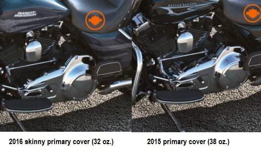

Motor with filter change - 3.3 to 3.5 quarts, Tranny 28 ounces, Primary 32 ounces (skinny) or 38 ounces. All 2016 touring bikes now have the skinny primary. Your 2015 "may" also have the skinny primary .... you need to look closely.
Torque 14-21 ft lbs.

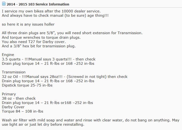

This may be what you are referring to. I saved it when I read it.

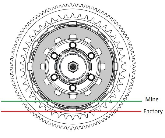

Long story, but I keep having a nagging feeling that I'm short on primary fluid. I just read through about 30 threads discussing *what* to use in the primary (seems RedLine shockproof is the way to go) and *how much* (38 to 40oz, less for the "skinny" primary cover but mine's a 2015), and some other chitchat, but my concern wasn't really addressed that I can find.
How can you check the level *on a primary that's already been filled* without draining and refilling? Back in the day, on my two-wheelers, the standard was to pop the derby and the level should just barely touch/cover the bottom edge of the clutch basket, but I seem to remember that's it's not the same on a Freewheeler?
Anyone give me a solid answer (or did you happen to look inside the last time you did a change to see where the level reached)? The quote above refers to the post that said, "38 ounces then check", but how do you check?
I now use an extra 2 ounces (40 ounces on my 2014). It is in-between the factory and "mine" setting shown.
This is a cycle sitting level check. I use H-D Formula+ and change with every engine oil change.
