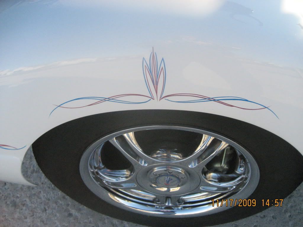

Herb, the wheels were the same size as the stock wheels from Champion, just chrome.....5 lug nuts. Sorry the picture is a bit fuzzy, but this will give you the idea.
This is a pic of the chrome wheels that came with my Goldwing Champion Trike.
