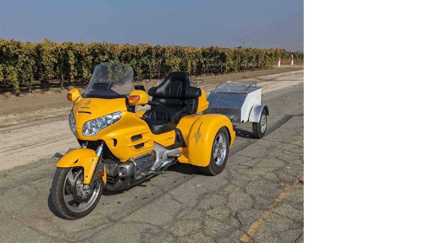

Lube & Ride
2 questions, I bought this little girl last year and love it. Question since you guys are talking suspension...This is a Champion conversion with IRS. Honestly coming off a two wheeler I find the ride very "rigid". Is that typical or should the ride be smooth? What lube am I buying to lube the drive shaft U-joints?
Ron…Welcome to Trike Talk..����.With 3 wheels on the ground the ride will never be as smooth as a 2 wheel bike….With 3 wheels one will always hit a pothole whereas with 2 wheels you can avoid them..
