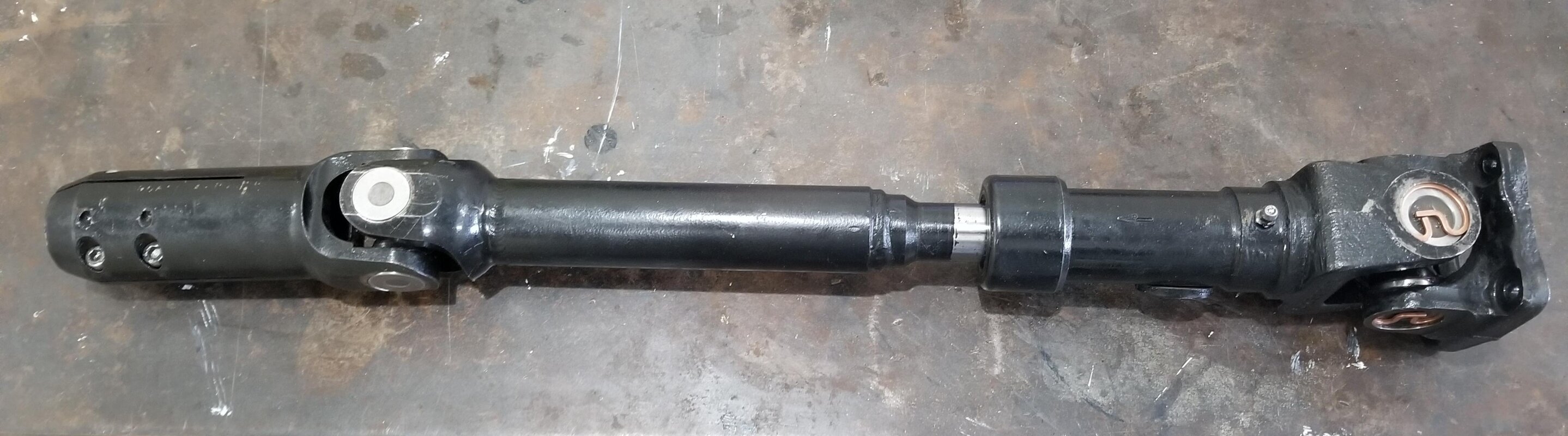

I just purchased my first Goldwing Trike after owning two other wings over the years, and I have a question on the driveshaft and brake calipers. I have worked in Maintenance shops for over 40 years and believe in a good PM schedule. So I plan to give this 2012 wing a through check out this winter. I have tried to contact Champion by phone and by email with no reply.
Does anyone know what U-joints are used in the front and rear of the drive shaft, and what auto do I look for at the parts store when it is time to replace the brake calipers? Plus the bike only has 32K miles on it and was triked at 2K.

I have good news. I pulled the driveshaft and removed the U-Joints, measured them and ordered new ones.
Now that this is done, on to the next project. Air filter replacement :)

How did you replace the front u joint? I thought it was unserviceable, mine is staked, not spring clipped.
