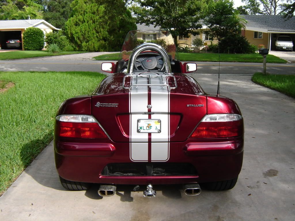

LB, check out this shot.
It shows the antenna on the rear to the right of the trunk. It looks like a cell antenna, and works fine. If I remember right it is made by Antenna Specialists. I'll get over to the shop where I got it and get a model number.
Good Deal Big Dog thanks for the help. I purchased the same cobra 45wx CB you are using, Camping world has them on sale this week for $80 for presidents club members.

my CB antenna did not make a hole into the body that you can see.
my CB antenna came off of a Kaw voyager many many moons ago and it will fold down when I want to put the cover on the Stallion.
I got a heavy duty "L" bracket and put another bend into it and mounted the antenna on the "L" bracket and the on the other end I did drill 2 holes in the trunk lip(not shown when trunk is closed).
the cable is mounted to one of the screws that mounts the "L" bracket to the trike.

With the fiberglass body you really need a non-ground plane antenna. Ground plane uses the metal body as a reflector. Using a ground plane on a fiberglass body will not cause whine but your range will be greatly effected.
OK Silverdevil I am going to try and make a mount similar to yours, I purchased an alum bar tonight from Lowe's, and will try my hand at making it in the Afternoon Saturday.
Thanks for the pictures.
Also yes you do need a NON ground Plane type ant, to work on the stallion well. Also one other trick DO NOT cut the coax cable it need to be 18 feet on the non ground plane setup. Go to the firestick web site lots of good reading.
