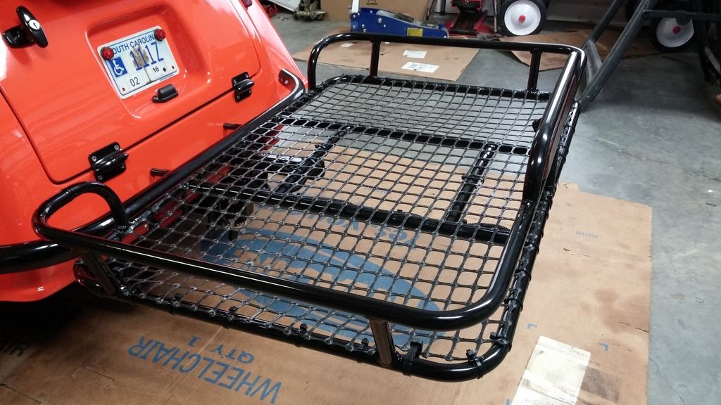

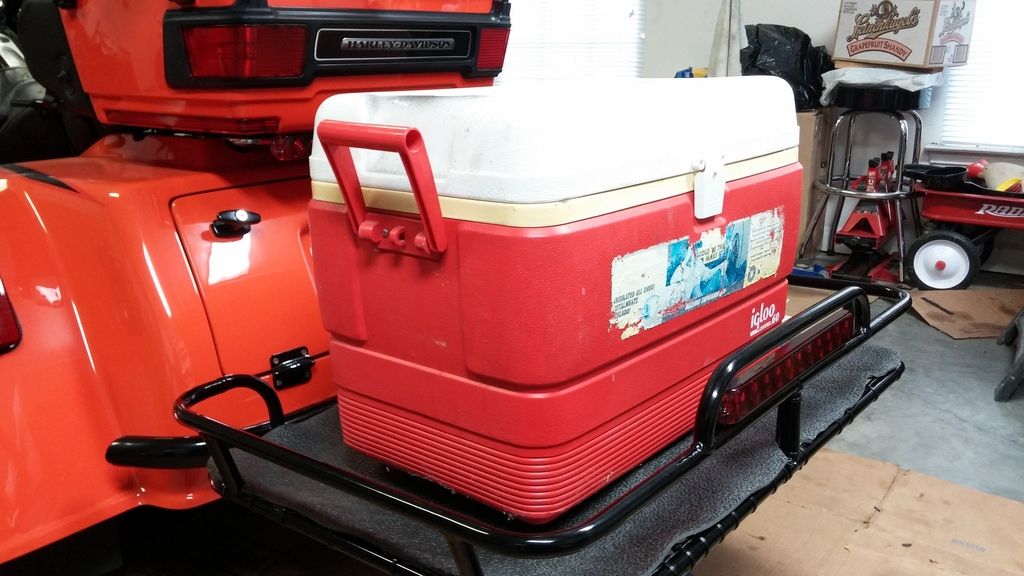

As it goes I can never leave well enough alone. I have had another carry rack built that hopefully will serve what I want it for many years to come. I added the ability to disconnect the rack without laying on the ground.
Now that will hold a lot of stuff!

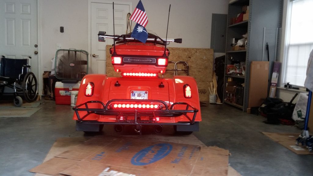

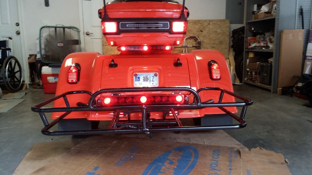

Looks good. I noticed it had wiring, is there lights or just wired for lights
There is a light bar on the rear. Has running, brake and turn signals. If I find some small id lights for the side I might add them later. For now Im going to add some high reflective red tape strips to it

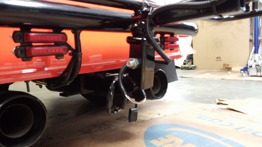

I bought another ball mount like this one http://www.carid.com/curt/class-1-ba...UV0aApdV8P8HAQ
and bought a raw 1 1/4" receiver tube http://www.ebay.com/itm/Curt-49506-R...aa337a&vxp=mtr
I needed the 11 9/16" length ball mount for the total length to get past my rear bumper.
I cut the ball mount about halfway through the bend removing the rest of the mount that I didnt need.
I made a 45 degree cut removing about 3" of the receiver tube that I didnt need. Using my neighbor mig welder I tacked the ball mount and receiver tube at the angle I wanted.

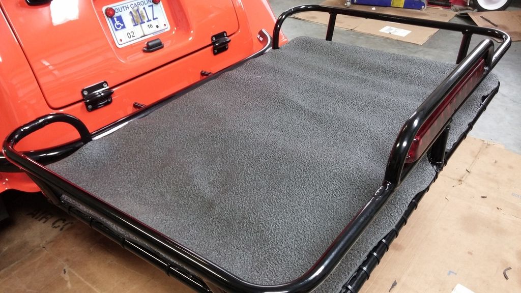

My buddy who welds, does metal fabrication for go carts and does the powder coating made the tube tray to my specs, finished welding everything as needed and powder coated it for me. This wider cargo carrier is for my modified knee scooter that I carry when Im going to museums or have a need for the use of it. It also can carry other things as well.
Being a A/K disabled rider its tough even in my garage to get on the floor to put the hitch pin in. Having the ability to remove the rack if Im at a location for a few days was something I had on my mind for several years with my smaller rack I was using.
I have a H/F trailer with a cargo box in the garage. I know there will be a time and place to use it. But for now, this rack I had help making will do for me as needed.
